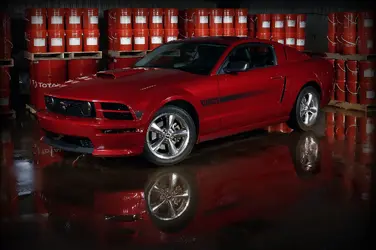

Since those barrels are filled with oil or nuclear waste, as our illustrious Admiral Ackbar pointed out, light painting with fire might not be the best idea. I'd stick to light painting with a flashlight or something of the like. I just bought a $10 LED shop light that should do the trick (trying to learn how to light paint too), but I've made do with a flashlight. Wasn't great, but it worked.
. What's better than a softbox? How about and entire ceiling or wall?
I agree with this, but I think that due to the limited power of speedlights, it would be a delicate balancing act to determine how close to position the speedlight(s) to the ceiling. Too far away and you just don't have enough light coming back and you'd need to crank the ISO (especially if using f/11-ish apertures). Too close and your effective light source would be an ellipse not much bigger than the frontal area of the softbox.
Regardless, I'm interested to see the results because I'm a speedlight guy and have not tried anything like this before, myself.

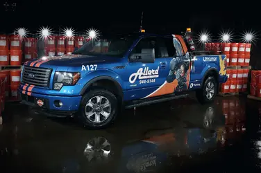

He does not need to shoot this with "one pop" of the lights...in a darkened shooting area with the shutter locked open, the speedlights can be fired 3,4,5,6 times, however many times are needed to get to the right exposure level. This is called multi-pop open flash.
A lot of commercial car photography over the years has been done using very large silks, stretched on frames or roped overhead, and the flashes fired through those large scrims...but what Village Idiot was suggesting is that, lacking huge, $3,000 silks and frames and grip gear, that he could fire the flashes off the ceiling/walls and get a BIG light source....and again, yeah, to pull deep depth of field like at f/11 with a low ISO, this might take more than one,single firing of the flash units. The exposure is cumulative....just do not knock the tripod in between firings!
Well, from start to finish, this was a 5-6 hour job. I had to clean the floor, setup the oil, clean the vehicles and setup my gear. The mustang was done using 2 x Speedlites with 26" softboxes, on stands, trigger buy my ST-E3 remote. The F150 was done on long exposure with manual pop of the flash. Now both pictures where stacked in photoshop CS6 and edited by me (just learning Photoshop, so go easy on me). Here's what I learned tonight...Bring extra batteries for your flash, bring extension cords, turn off cell phone, trucks are bigger than cars, bring more beer and I know nothing about light. It was fun, I had thought of this awhile back, and now I got to do it. Am I discouraged?...yes! Will I try it again?...Hell yes!

The truck turned out pretty well, the mustang could use more lighting on the front.
good job. I trust those links I gave helped?
It did, I wasn't quite sure how to tackle it. I was definitely under powered with the speedlites. Painting with flash was the way to go here. I also was judging my work through the camera's preview screen. A laptop might have been better to helped to see where I needed adjusting.
