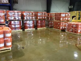

I had sometime this morning to sweep the floor and hose it down. I then setup the oil, as I was planning for the background, so you guys can get an idea of what I was going for. I was planning on turning the lights off for the shoot and use some kind of high powered light behind the car. What do you think? $image-1.webp$image.webp
shoot the BG before you pull the car in. light is as you wish, I'd probably go multi-exposure here as well.
I'd be using a single strobe, no ambient, and multiple exposures stacked/composited (camera stationary, f/11, locked settings/focus) if I were doing this. I'd probably only light paint to get highlights down the side of the car/fenders.
You you are going to light paint, you're still going to end up with a multitude of exposures to combine, combined the best parts light up: http://www.pgdesigns.co.uk/blogInner.php?blogID=11&id=11
I know this may sound stupid but how using about a couple of builders' lights, shut them off or move it as you 'shape' the car?
