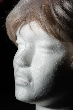

Practicing for an upcoming project, and need some help. As you can see Myrtle, has had a hard life, and has more than her fair share of scars, skin blemishes, and terrible hair, and unlike my wife sets patiently while I fiddle with settings. Best of all she NEVER COMPLAINS, and no quid pro quo.
The first shot is a 7" reflector with barn doors and a 10 deg grid. f/6.3.

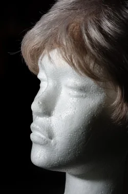

The second shot, same 7" reflector, barn doors, and grid, but with a diffusion sock added. f/5.6

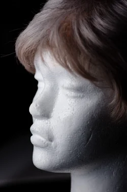

The last one is with the 7' reflector, barn doors, grid, diffusion sock, and the addition of a 2nd diffusion screen in close to the head. f/2.8
Assuming I am dealing with a similar type "Myrtle" in real life, I like the softening effect of the shallow depth of field and double diffusion in the last image, and the more gradual transition into shadow. The real life "Myrtle" will be a head/shoulders shot.
Any other suggestions on lighting??? What about pose - side view, 3/4 view, Looking straight ahead, looking up, looking down?

I actually use 7 inch metal reflectors, honeycomb grid, and one or two or three mylar diffusers over them as my hair/accent lights. One thing I can tell you is that the angle at which the light comes in can tremendously impact how specular the light is.another thing using an 11.5 inch reflector in the same grid and diffusion changes the light quite a bit mainly because it's a bigger light. A 16 or 20 inch pan reflector in the same grid and diffuser is an even softer light.
Basically if the light strikes the subject from 11 or 12 or one or 2 o'clock, the light will be more specular then if the light comes in from say a frontal angle or side angle like nine or three or five or 6 PM this is of course in relation to the camera, these clock positions I speak of. Well got to get back to work

I'm leaning toward the 7 inch reflector, 10 degree grid, barn doors, and double diffusion as the main. Then using reflectors to fill as needed. Placing the light just above the top of the head angled down, at about 9 o'clock, with the subject facing toward 7-8 o'clock to get the profile. Use a small rim light low and behind to separate the background, and possibly a small kicker with a snoot to place a small brighter oval "30's look" over the eyes.

That sounds like a very,very small pool of light, and probably quite low in overall intensity, with only a 7-inch reflector, a 10-degree grid and two diffusers.
I'm not sure...with my system that's very weak light, not easy to use as a main light except on one person. I understand what you're after now. I might try wider grid options if you have a access to a 20 or 25, a barn door set would likely work very well. A 10-degree grid and barn doors could possibly be a very narrow swatch of light.
Buuuut...it could work! it all depends!
It is but since it will be a head & shoulder shot most of the light will be concentrated on the face. Playing around with the set up last night, and believe I'm getting close. I tried moving the main further away but quickly discovered that the shadow line became to hard. Surprised at how rapidly this changed with only a minor adjustment to the distance. My only explanation is the double diffusion. I also learned how much ambient light affects this type of shot. Adding negative fill using black foam core, and turning off an overhead light added the deep black in the darkest shadows, and taping a small white paper oval to the foam core brought just enough fill back in eyes.
Still have a couple more tweaks to play with but I believe i'm ready. Actually have a couple of projects in mind that I want to try this on. Thanks for all the comments.
