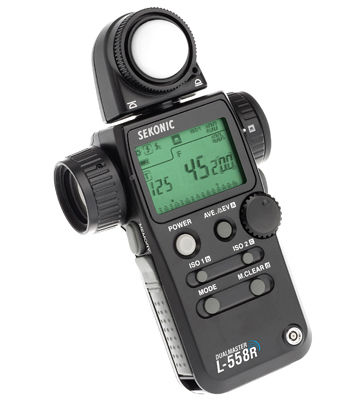

I've got a hand held light/flash meter...and the only time I tend to use it, is for metering my studio strobes...and even then, it's not all that often.
With digital, it's just so easy to shoot and then check the results. I set the camera to display the histogram and use that to set my exposure.
My meter:
And yeah, it's great for indoor set-up shots but I never use it in for typical photography. In fact mine is lost somewhere inside the house and I haven't seen it in well over a year. Probably more like two. ;)
