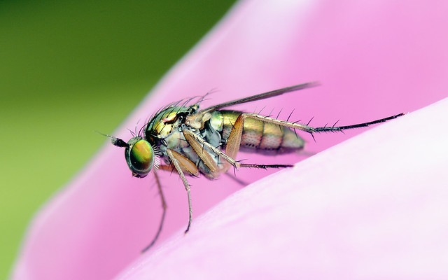

Shot at min focusing distance of .30m on my tokina 100mm f2.8 macro, I can't recall if this was cropped(most likely)
^ Nice shot Jake! Any additional lighting used?
