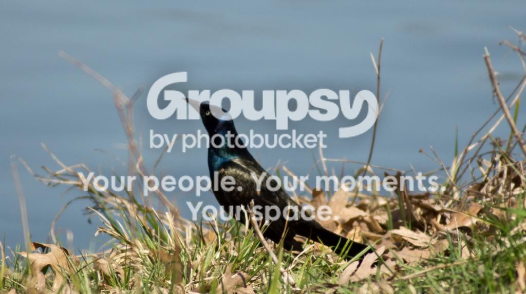

I am contemplating purchasing the new Tamron 150-600 lens for my Sony A77 body. For me, this is a major purchase, price wise. I am looking for thoughts as to how much of an improvement I might see under the same shooting circumstances compared to the telephoto zoom I am using now.
The lens I have now is a Tokina 75-300 4.5-5.6 that I purchased used from the large online auction house.
Assuming I took this same picture under the same lighting/distance etc, with the Tamron what can I expect as far as sharpness etc.
shutter speed 1/160
F6.3
iso 640
300 mm focal length
The distance was about 30 yards, 7:30 pm so the light was starting to wane a bit.
Cropped about 1/3 out of the original
Shot with a window mount from a stationary vehicle.
I know what I am asking is very subjective in nature but I would appreciate any and all thought.
That image does not look very in-focus/sharp. If this is a typical example of your lens, I would suspect the new Tamron would be better.
My wife's Tamron 200-500mm is much sharper than your image with the same crop, using the Sony A57.
I think we are all waiting for some reviews to come out for the Sony. I would like to get one too. But i would imagine your IQ would be better than your current lense
Thanks for the feedback! I agree about my photos with the Tokina never seem sharp or a tad out of focus.

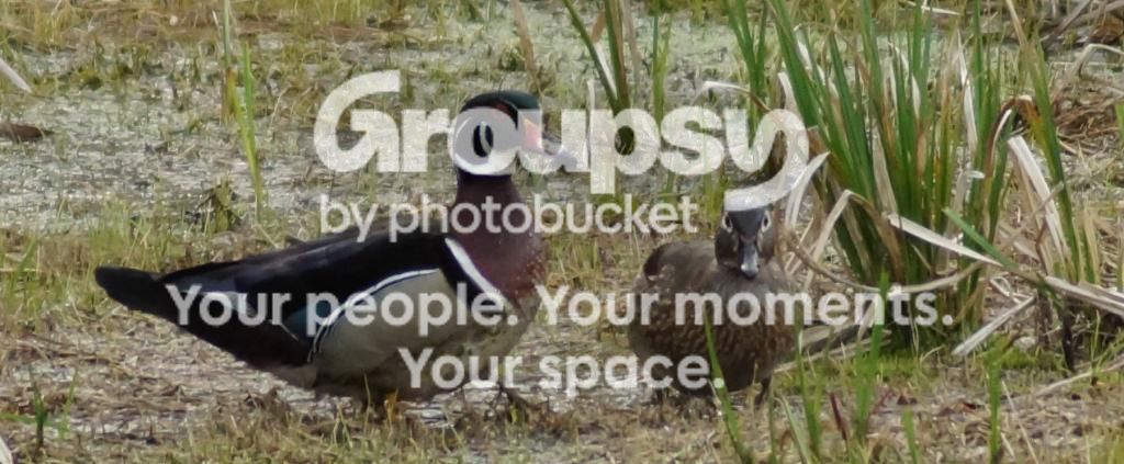

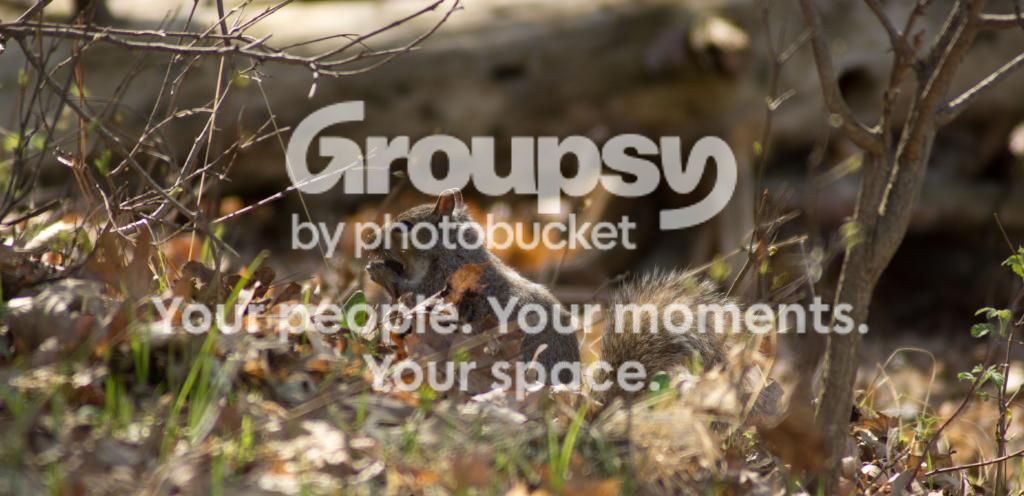

I was out and about with my A77 and Tokina today. I shot in raw, and turned off auto-focus and used focus peaking in manual focus mode. Marked difference in sharpness I think, although I had more light. It makes me wonder if a lens can fool a sensor when in auto-focus mode or are these pictures much sharper because of the light and shooting in raw?
If you get better results in MF ... maybe you need to play with the micro focus adjustment.
You should continue to shoot in raw.
Is you peaking level at high? The second shot missed the bird and got the grass in front.

Yes missed the focus point in a couple of shots . Nice shots BTW, just a little more practise in MF.

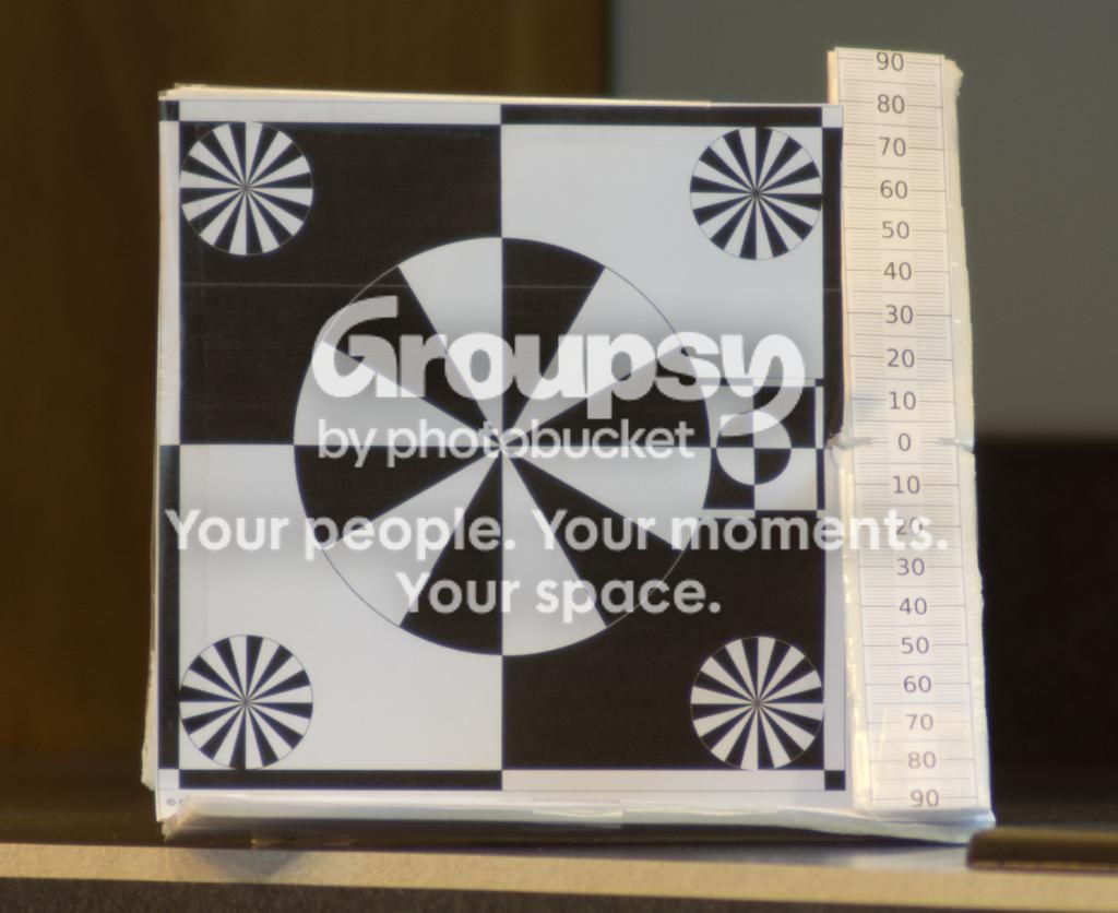

I did want to thank you guys and gals for the suggestions and help.

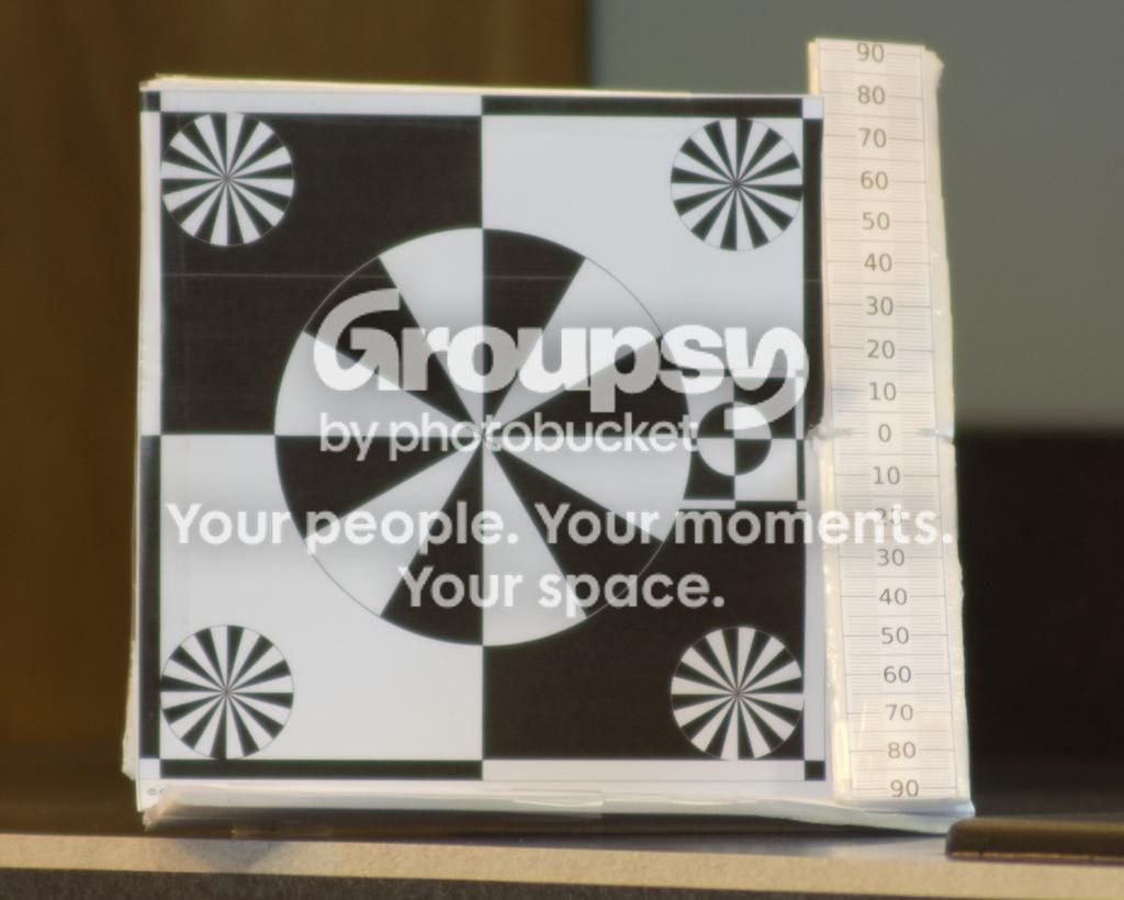

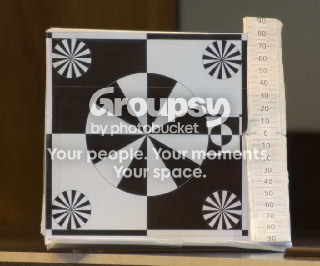

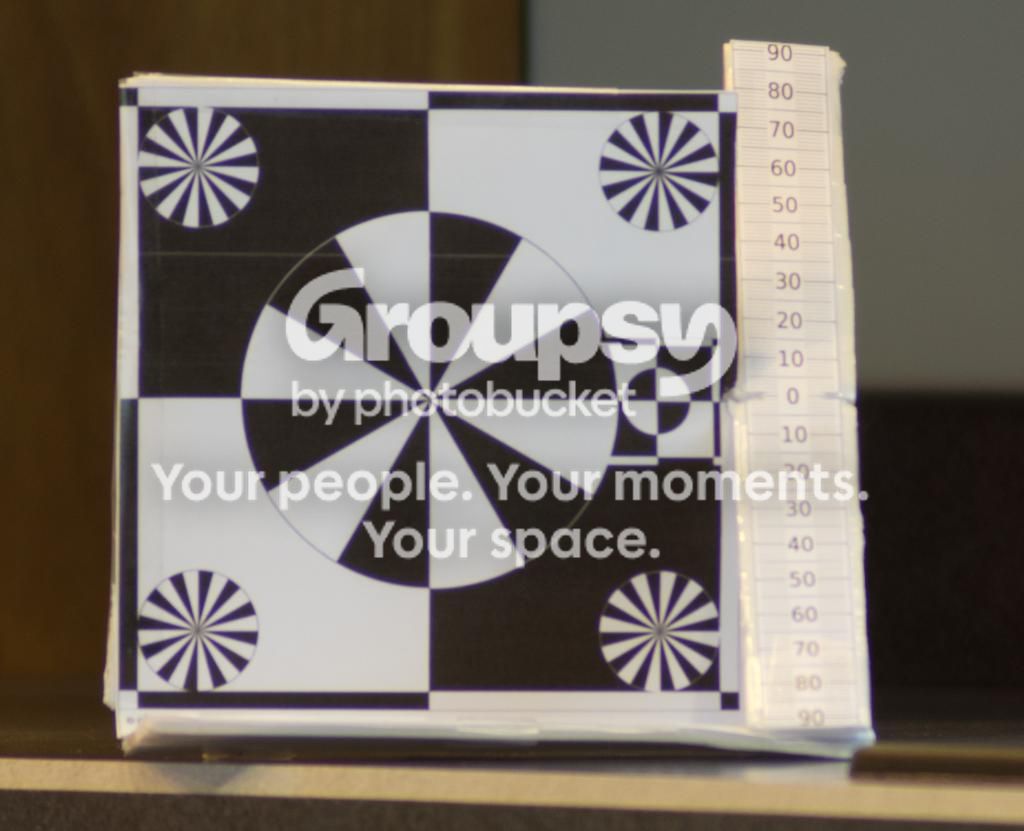

I printed and made a calibration chart. These are three photos I just took, indoors with the camera set on my tripod and set on a 10 second timer. Shot in raw, auto spot focus, no editing other than to crop and convert to jpeg.
The first picture has a correction of -4
The second picture has 0 correction
The third picture has correction of +4
Keeping in mind that I messed up and have Scotch tape over the bottom portion of the scale, does it look to your eyes I can give it even more - adjustment?

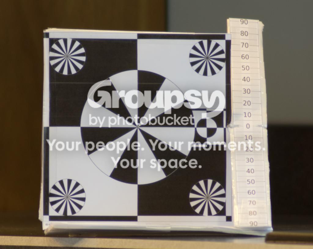

-7 correction
And this one is -10 which is too far.
Does -4 or -7 look closer?
