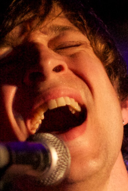

I can tell you (owning a 5D II) that taking the ISO up to 1600 is no problem. 3200 actually looks pretty good. And even ISO 6400 is ok as long as you don't display the images in large size (web size images really hide the noise). A while ago I dropped two images into a 'set' on my Flickr account to show this.
The first image is the full image (uncropped) sized for Flickr. This was shot using a 5D II at ISO 6400.
The second picture is the SAME photo (not a different shot) except I made a 100% crop on just his face. At 100% where you can see every pixel you can tell that the image has quite a bit of noise... but it doesn't show up unless you look at the image at this size. Check the shadow areas in the full size (uncropped) image and you'll see that there is obvious noise at ISO 6400... but only visible in the shadows.
