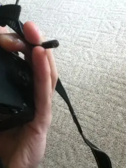

Can you tell what connection that is in the photo I posted? Is that the standard connection for flashes?
The connector in the image you posted looks like a standard male PC connector.
