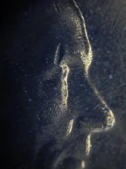

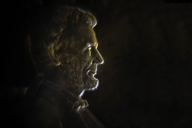

How macro do you want to get and how much fun do you want to have. Many options. Oh and these are a 50-D that I have on a stand. Single frames, just having some fun.
