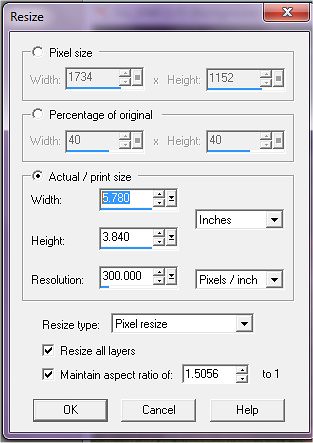

Attached is a screen shot of what my resize options look like. You can see if i keep 300 dpi it says my picture can only be printed as smaller than a 6x4....
SCREENSHOT by reachingforthestars07, on Flickr
http://www.flickr.com/photos/21143231@N05/6114921212/

I just read another thread that said the ratio for a 8x 10 or 16x20 should be 4:5 but as you can see in my screen shot...my ratio only allows me to type in the first number and the second number is automatically 1...maybe thats the problem..i dont know.

When you deselect 'Maintain aspect ratio', you need to make sure the height and width you manually enter match the aspect ration of the print. You need to deselect the 'Maintain' thing first, then enter your h&w. Otherwise, the software will resize it the image maintaining the existing aspect ratio, and if you don't enter any new numbers your print will be off.
The pixel dimension is less important than the ratio (2:3, 4:5, 5:7, etc).

Un-checking the 'maintain ratio' box will generally result in stretched images. It needs to already be the right ratio before you crop/resize to change the pixel dimensions.

You won't like the answer but here it is. Your problem is PSP 7. PSP 7 and earlier versions did not have, as you have noted, a standard print size cropping feature. You have a couple of options. Upgrade to the new version of PSP or pick up another piece of software that will crop to a standard print size cropping feature.
One other solution you might want to look at. Do all of your color correction edits in PSP 7, save a copy of the photo and open it in what ever Nikon provided with your camera. It should have a crop feature that will then let you crop the photo to the print size you need.
