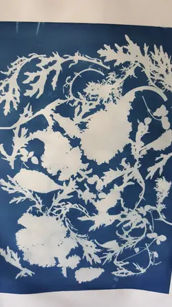

Dave 442, I rinse in water after the hydroperoxide rinse the problem is actually too much contrast, if that makes any sense? The gradients just disappear.
Before and after, to show the loss of range.
Isn't hydrogen peroxide used to enhance the deep tones and contrast? I don't think it's absolutely necessary to use it, if the print has been washed properly after the exposure is completed in plain cool water. You can let it dry down for a few days and assess the color before you decide whether or not you want to alter or deepen it.
And you are correct in thinking it could be just the exposure time. You definitely have a few variables to play with.
I think you can always try a longer exposure. If your opaque areas are not receiving enough UV light then they will wash out. Are you using actual objects or a negative? I had always used objects and then sunlight to expose.
