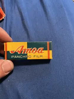

Hi, I recently bought a Minolta 16 camera. With it came a few boxes of Amoa brand film.. it’s black and white and says high speed. I’m wondering how I’d go about developing it. I couldn’t get rodinal to work, but I don’t know if my dilution would’ve been right. I have no clue what developer would’ve been used back then, and any chemicals needed in general for fixer/stop. I’d like to try experimenting with this camera.

For very old BW film I use Kodak X-Tol diluted 1:1. Now shooting old BW film I would shoot it at 1 stop over but develop normal. I'm not sure what ASA/ISO that film is but very old verichrome (125 ASA) I dev in the 1:1 Xtol for 10 mins.
Xtol at 1:1 reduces the "base fog".
Would I use a regular fixer, or would I have to use a hardening fixer? Also, does it need any agitation??
I use Ilford rapid fixer which is non-hardening.
