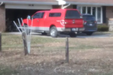

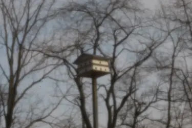

I switched my Canon to Manual, added a short (2") black paper tube with a .016 pinhole at the end. The PH to sensor is about 4" making an f240.
These shots look okay on the small camera screen but when viewed on the monitor the small format becomes an issue. As you mentioned a 4x5 or any large format really works well.
Truck in drive. Martin bird house
As our images demonstrate, pinholes are really good at showing up sensor spots!
