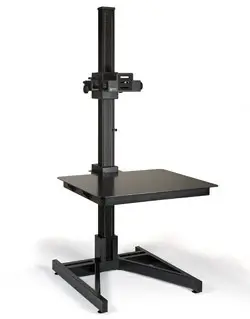

Step 3. Buy one of these.
Step 4. Print digital photo, put on stand and take photo with film camera.
