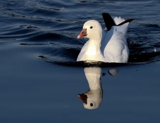

Hey, thank you for the reality check, really! The Los Angeles river was turned into a flood channel decades ago, walled with concrete and fenced off, getting a boat or hopping the fence are not viable options (at least not for my broken old body), thing is, even though it's a wash at this point... Heron, Egrets, ducks, and assorted other birds call it home and it's right out my backdoor. My focus at this point of my life is making people aware that nature and wildlife are just outside our back door. I'd be willing to bet that even in Alaska there are people who see the little white goose with black wings (Ross' Goose) and don't know it's rare to see one south of the arctic circle.
Here's one in SoCal last summer.
