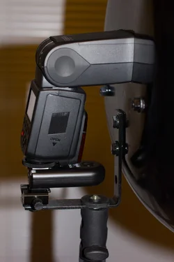

I just finished my beauty dish project. Here are a couple pictures. They might give you some ideas.
