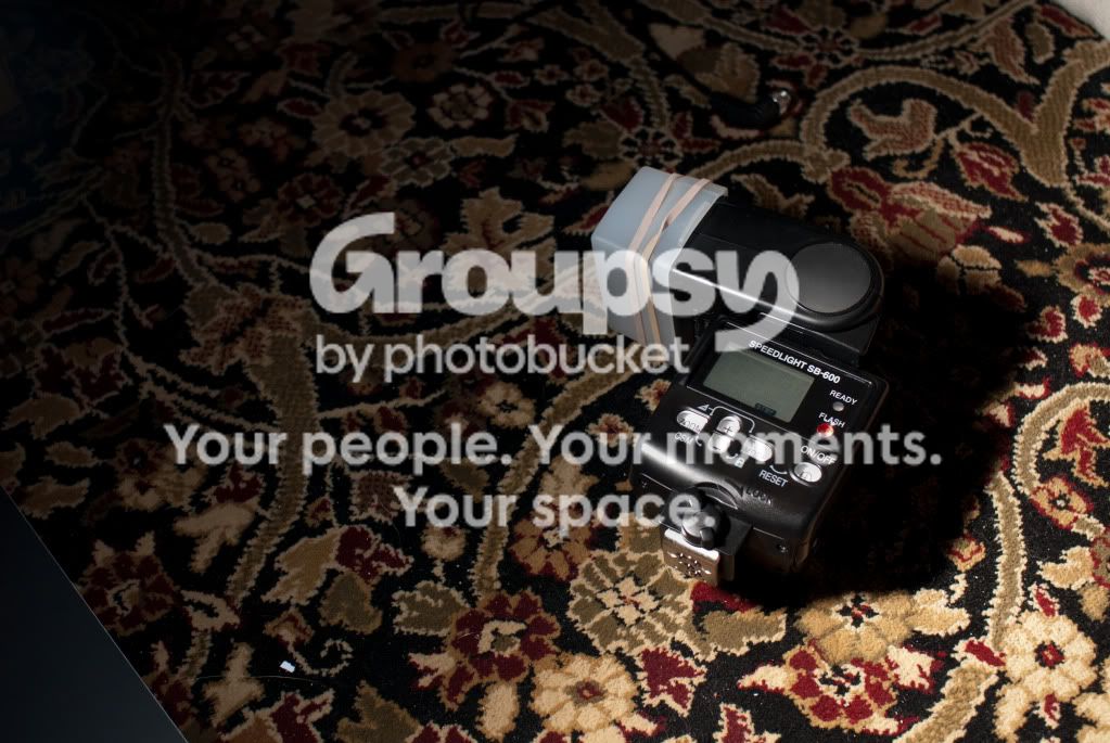

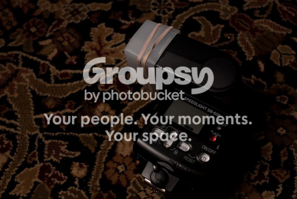

Cut the Bottom out and make it into a Flash Diffuser,use abit of tape to keep it on the flashgun!magic!
It also work's with Pop up flash really well too.

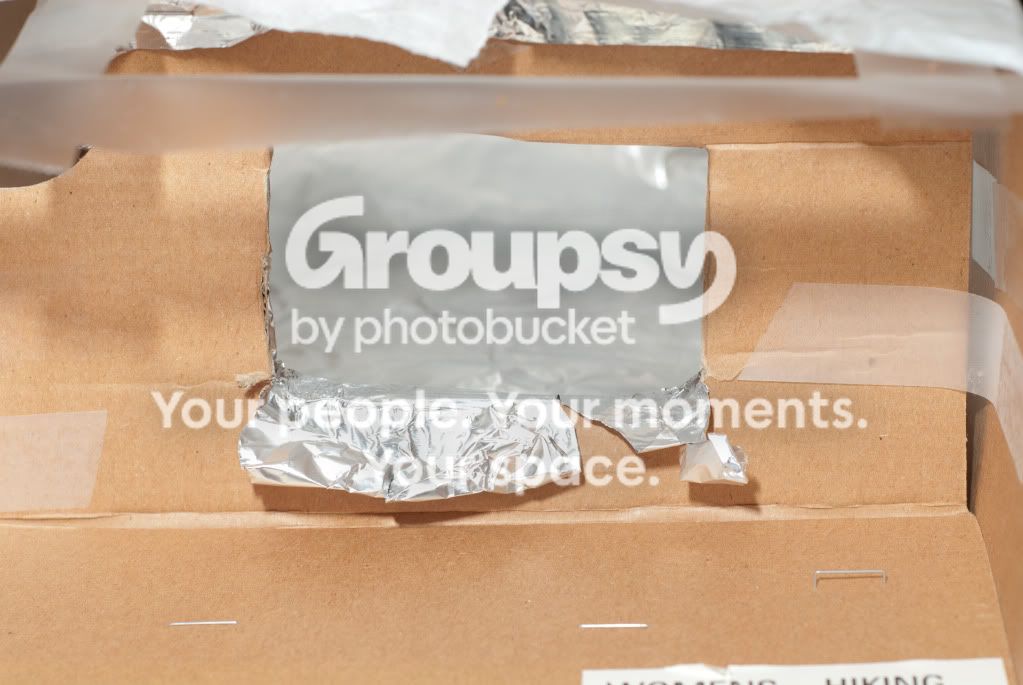

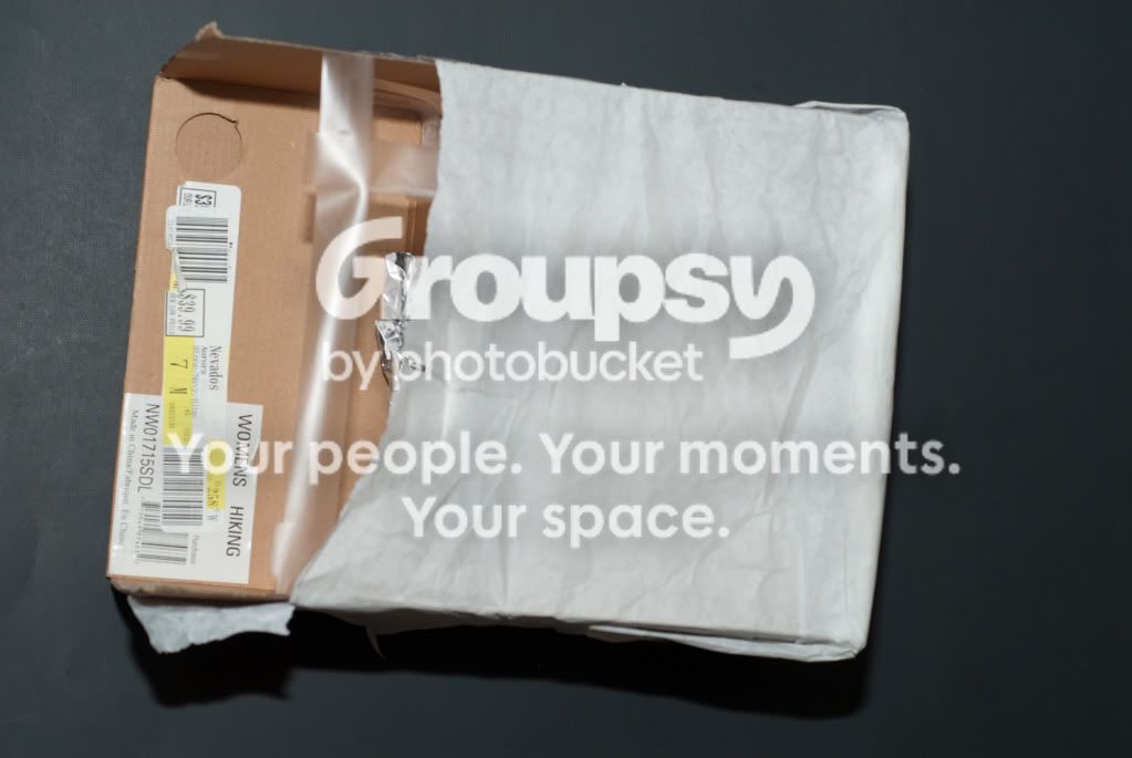

Take a shoebox, then cut off one of the ends. About 1/3 of the way in, put a piece, with a hole for your flash. cover that enclosed area with tin foil, and on the front of it, place some semi translucent paper, and for this, i used the wrapping they wrapped my shoes in. Here are some pics of it. Cost me zero dollars, and it worked great when i didnt have the money for real diffusers.
Some shots of it:
With diffuser:
With no diffuser:
As you can see, it diffuses well, and you dont get hard shadows or bright spots.
