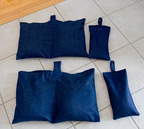

After a recent tip over of a lightstand (no damage, I saved it well before it hit the ground), I looked around for prices for sandbags and was surprised at what they cost. I thought it would be interesting to see what DIY ones would cost me, and it was a huge savings without a huge drop in quality at all.
Mine cost me about 1/10th the price of store bought ones that I could find locally. The small ones are single 6 pound bags and the larger ones are 28 pounds each.
I use the smaller ones as counterweights for the boom and the larger ones to hold the lightstands down and keep them from tipping over.
I made 2 of each and the total cost of the project was about $8.25 Canadian, including the pre-dried sand.
Credit has to go to my mother for the sewing (labour is where I am sure I saved the most on!), she did an awesome job. Each sand bag is double lined and triple stitched for longevity... not that I will be all that hard on them anyways.

Sure... Large bags are 14 X 22 inches and the smaller ones are 12 X 4 inches. They each hold sand and when filled are about 3-4 inches thick. Each has a "handle" built into it for being held in place on the base of the stand (not really needed for the big ones, just handy to grab on to) and to slip over the end of the boom for a counter balance to the setup.
I used my reflector boom (way under-strength for the application) just to test it out, and the two smaller sand bags are perfect for balancing either the 28" or 50" Apollo softboxes holding two battery filled SB-600s up in the air above the subjects in a nicely balanced manner.

My thought was also to see for how little I could make it, and for $3.25 I had a 66 pounds worth of sand in the trunk... lol

I just thought it a fun and easy project for someone with a few hours, a little sand, material and sewing machine could do for near nothing. I also thought it would be nice to share this as it is something useful for anyone that uses lightstands indoors or outdoors and is VERY affordable.
Getting busted lights and softboxes that tipped over becuase of a breeze sucks. :)

How did you "load" the bags? I assume you didn't just pour some sand in there then throw it up on the sewing machine...
Uhhmm... yep! Is my mom good or what! :lol:
Actually, the trick is to not overfill the bags and to use pins to hold it closed. It also helps to have a helper (me) hold the bags at an angle and to raise it maybe a 1/2 inch high so that it all slides smoothly through. I took the weight off and she did the rest. :mrgreen: That is for the inner bag that holds the sand. The outer "skin" is a simple jean material and by that point, the sand bag is sealed and slipped into the pocket of each side of the "saddle bag". Honestly, not one grain of sand escaped during the whole process. Some care had to be taken, of course.
Edit:
What I am probably not explaining properly is the fact that the small bags are really 2 bags in one... the bag that holds the sand and the bag that becomes the outer shell and handle. The larger ones are 2 bigger sand bags placed into a single 14 X 22 bag that is stitched up in the middle so each bag sits in it's own pocket and remains on it's side. Each bag has a small "handle" for ease of grabbing and a offering a way to be secured to the lightstand if needed. Each "outer shell" is also sewn closed, containing the unit into one completed sand bag. I suppose it could easily all be done with one "bag", but this way everything is much stronger and last longer.
