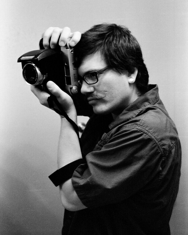

My current avatar was taken using two mirrors. One problem you will encounter is that fine details will often have some "ghosting". It's not very noticeable, but it's there. Quality of the mirror is a factor in this, I'm sure.
edit
Nevermind. It's not my current avatar, lol. It is everywhere but here. :lol:
This is the picture I was referring to:
I can see in that picture that the camera was set to f/8. Shutter speed was probably 1/60 or 1/125 - I can't remember for sure. I have no problems hand holding this camera down to 1/8 second... Subject movement is usually the deciding factor when choosing a shutter speed.
(Very good picture btw)

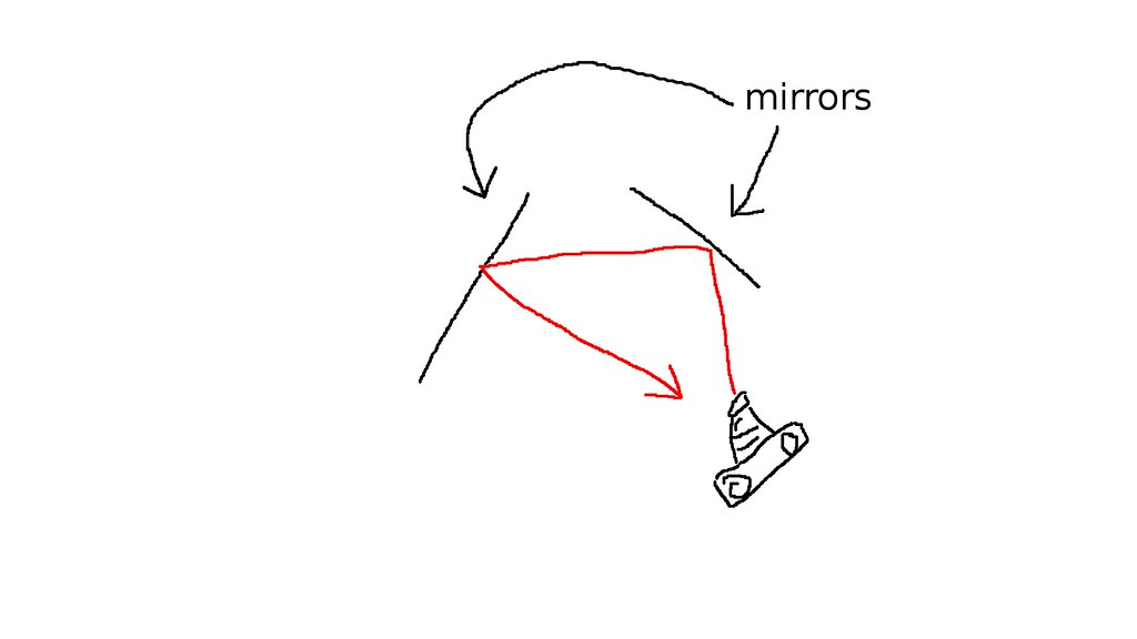

This is a very crappy drawing of how I did that.
Focus distance that the lens must be set to will be equal to the sum of the red lines.
