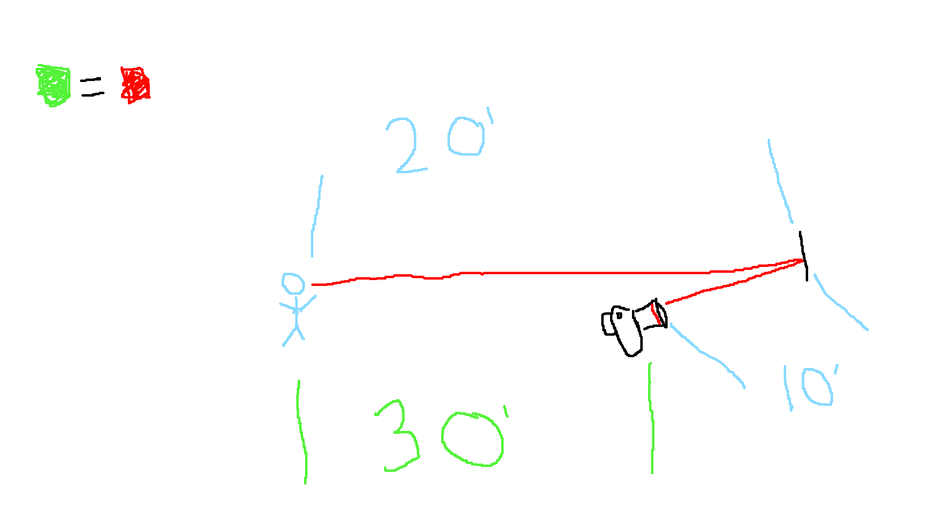

Do the same thing, but without the mirror. (I'm just making these numbers up, but you get the point) - say the mirror is 10 feet in front of you, and the dwarves are 20 feet behind you. Camera is aimed at the mirror.
(I am also assuming that the lens you're using has a distance scale on it) - Focus on the mirror. The surface of the mirror is in focus, but the dwarves are not, because they are another 30 feet away. Now focus on the dwarves - the scale on the lens should be showing that's it's focused at 30 feet.

(Drawing not to scale.) :lol:

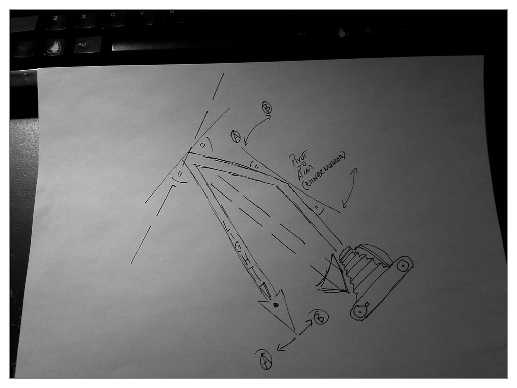

Well, it doesn't change the minimum focusing distance, if that's what you mean. That is a 'feature' of the lens and cannot be changed. What the mirror does is modify the camera-to-subject distance. If you are holding the camera, aiming at yourself in a mirror that is 5 feet away, the "subject" is 10 feet away.
You're not focusing on the surface of the mirror, but your reflection in it.
edit
Lets say that the minimum focusing distance of your lens is 2 feet. The mirror is 1.5 feet away. Too close to focus. But the "subject" (you) is 3 feet away (the distance to the mirror and back) - within focusing range of the lens.
...Don't make me post another crappy drawing, lol. If I have to do another one, it will be with pen and paper and get scanned. :lol: I can't draw for **** with a mouse.
You'll figure it out in a matter of seconds, but this is the general idea:
