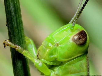

I have taken shots in the mid to high 30's... that were sharp! Was there diffraction? YES... was the picture better for the increased DOF? YES! :)
shot at F32
