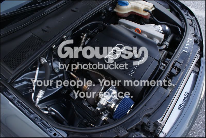

Had to take some updated engine bay pics for a magazine spread my car is going to be in in Nov. Some of them actually came out very well (IMO) so thought I would share!

Oh the engine bay is sexy. Technically the exposure is correct, so I guess you got what you were after.

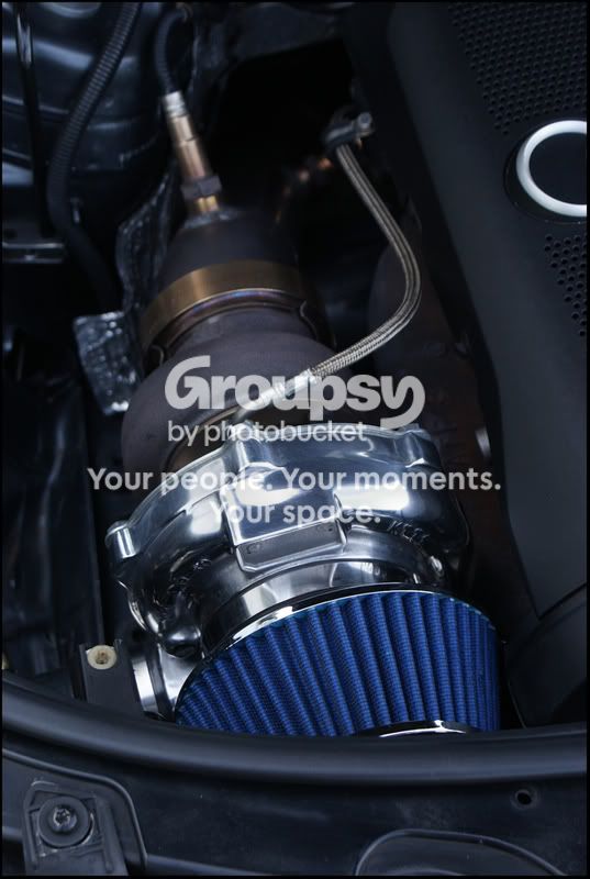

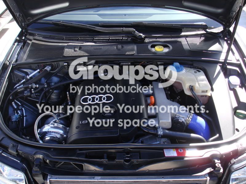

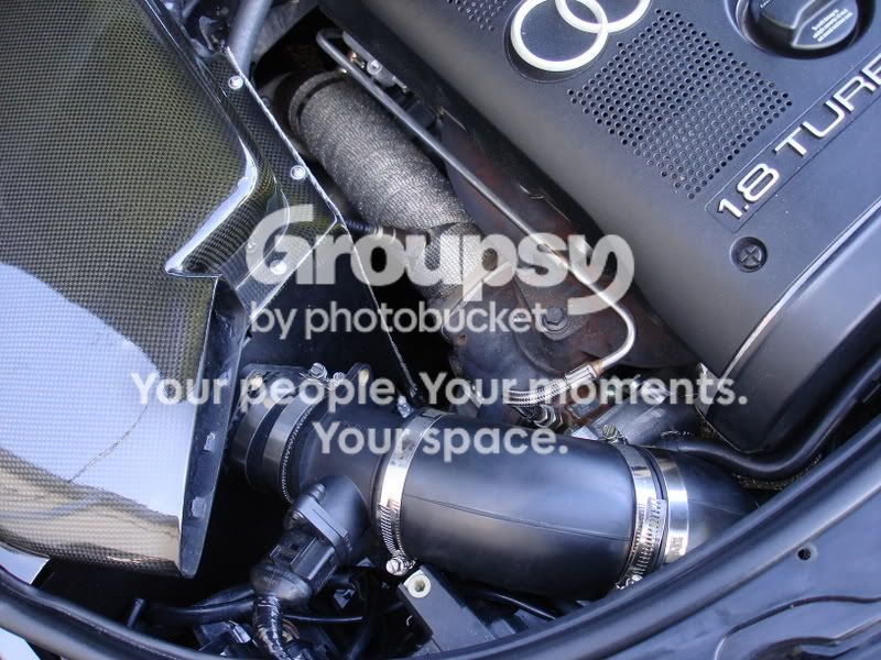

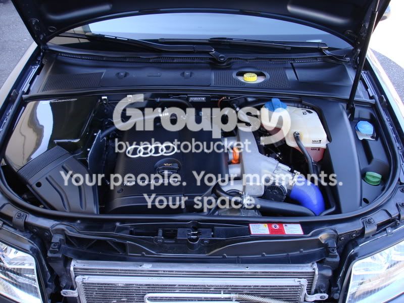

Ok, the first photo is good, but I think it could be cropped in tighter for a stronger composition. The two triangles of ground take away from the photo. I'm no sure what I'm supposed to be looking at specifically. Other than that it is great lighting, sharp focus, and I'm sure it will work for what it was taken for.
The second photo, much better. The shallow depth of field really helps lead the eye to the turbo. A little brighter and a bit sharper would really help here.
It's a turbo, and allows a 1.8l 4 cyl to make 500hp :wink:

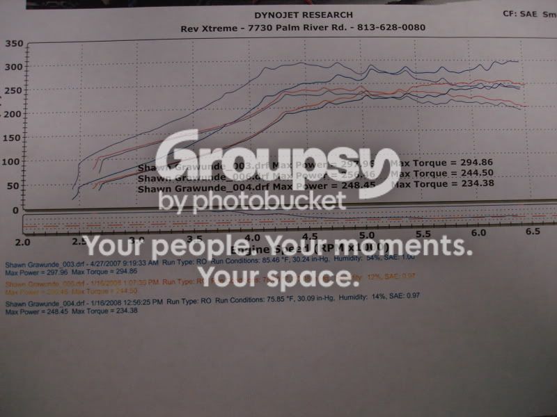

I dont have a dyno with my setup now on high boost. The high number here was the setup I had prior (2 turbo's ago) with a GT28RS. Straight pump gas, 20psi, 298whp 295wtq which is equivalent to about 380-390 crank HP and torque. The lower two numbers are with a 3071R, pump gas, 12psi right after I built the bottom end of the motor
My setup now with the the 3076R makes about 330-340whp on pump gas 20psi, MS109 + 28psi is right at the 400whp mark which is 500hp @ the crank ...
Thanks for calling me out and proving yourselves wrong ...

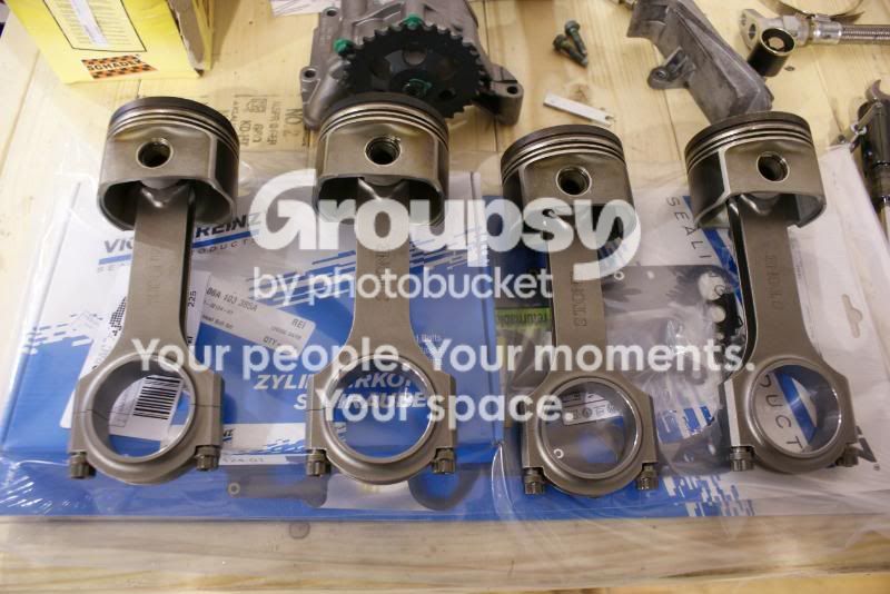

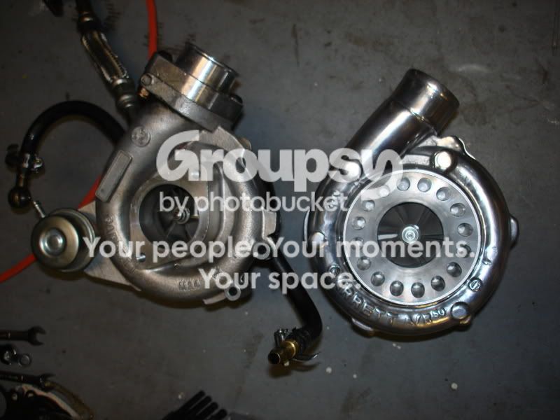

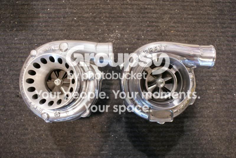

And to show the setups Ive had
GT28RS
GT3071R

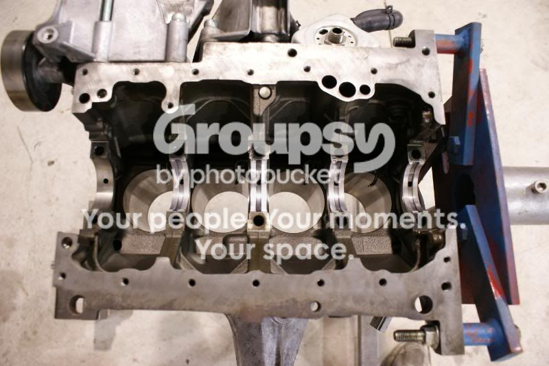

Built Bottom End

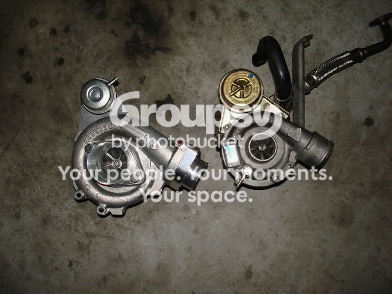

28RS - Stock K03
28RS - 3071R

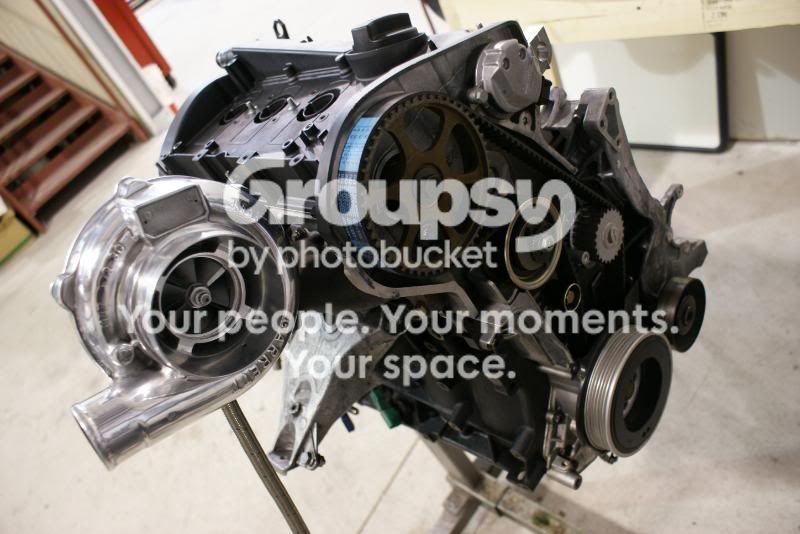

3071R - 3076R
