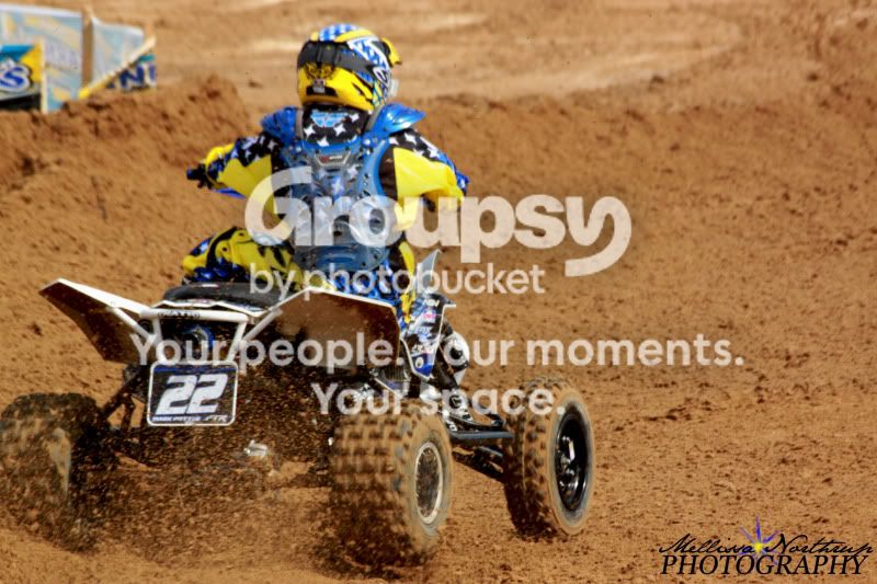

I've been fiddling around with my Canon Rebel T1i for about a year and a half now. Here are a few photos to show my work. Please give me tips to help better my work! Thanks again! :)
#1 - A shot I took off my Hubby at his race at Dade City Motocross.

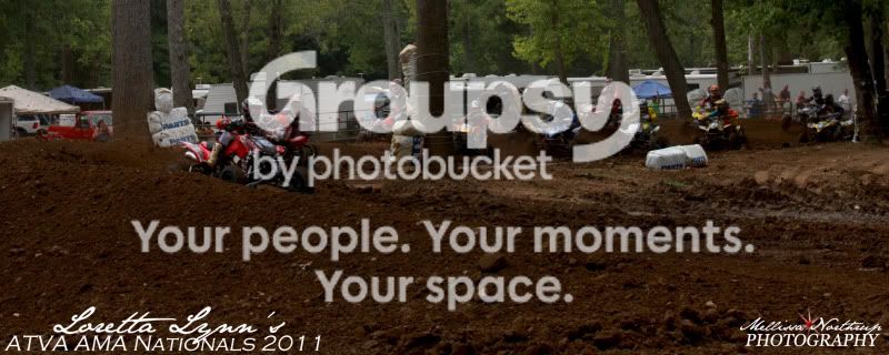

#2 - A shot I took in Tennessee at Loretta Lynn's Ranch for the ATVA AMA Nationals.

#1
The first thing I noticed in this, is that it's quite soft. Meaning: you've either missed the focus or moved the camera during exposure. I'm guessing the latter, because everything in the frame is blurry. If you'd missed the focus, then something other than the subject would be sharp - now: nothing is.
Your exposure seems fine to me.
On your composition, it's good that the trucky thingy is placed in lower left => driving into the frame. Very often (most times) when dealing with motion, it's better to have the subject moving into the frame, as opposed to out of it (trucky thingy in upper right corner).
That said, you've cut off part of the vehicle (part of the wheel). That bugs me!
So, work on your panning and zoom enough out to be sure everything's in the frame. You can always crop out a little if you need to.
Why were you shooting at f/10 and ISO 400? You could easily get a shutter speed of 1/1500th here, which would freeze the vehicle. f/4 and ISO 200 and around 1/2000th of a second. No need for such a low aperture as f/10 in this shot, IMO.
What I would do: bigger aperture meaning faster shutter speed to really freeze the bike OR pan the bike, which should be quite possible at 1/100th of a second. I'd try to frame as you've done, but not cut off part of the bike.
#2
Technicalities: seems underexposed to me...and not too sure about the focus. Seems a bit soft, but hard to say on such a small size. Again, f/10 isn't ideal. Shot in auto? Auto often prioritizes smaller apertures rather than bigger and bumps up the ISO. This image is noticeably darker than the first.
Composition: IMO, there is too much dead space in this: left of the vehicles and under them. It took a while before I noticed the other bikes in the back. Not an ideal background (RVs), but you got to work with what you can.
I would lighten it, crop tighter on the bikes, quicker shutter speed.

#1 is OOF - Out of Focus
#2 is underexposed - Or in other words too dark.

Content wise, #1 would be much stronger if the rider were approaching, rather than going away from, the camera.
In #2 the intended main subject(s) is to small in the frame and lacks visual weight.

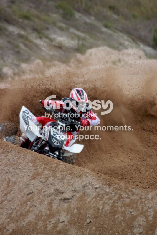

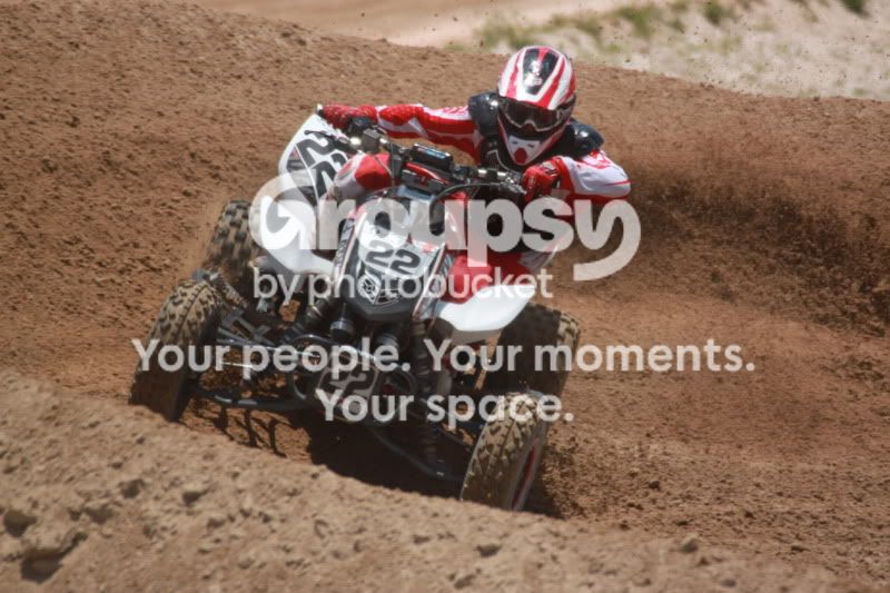

@ Compaq - Pretty harsh.. lol but thanks. I use to shoot in the auto modes until a fellow established photographer told me how to use the Manual... (Before then I didn't know what ISO and Shutter meant.) So she said when your ISO is up but never over 800 your Shutter should be down and the opposite. I've been fiddling with it ever since. But as for the clarity I have two more shots (From different times..) which are unedited so you can pick at them as well.. :) thanks again!

As for the two new shots, they are still soft. At which focal length did you shoot? And which lens?
But, ask yourself, would you buy blurry shots? Action shots like these are impressive if they are razor sharp. I.e. the earth flying everywhere would look wicked if sharp.
That said, they aren't bad.. Just, imo, lacks technical perfection.
