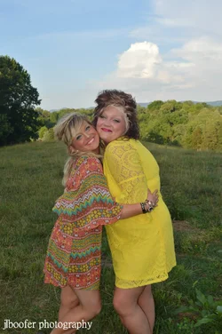

I have been shooting portraits for about 3 months and I admit that my biggest hurdle is exposure. Any advice on these? I'm learning but I'd like a critical eye to give me some guidance. Thoughts?

You will get more "advice" if you post fewer images. Exposure can be pretty subjective however.
On this one, the light is very close to them, so the light's rate of falloff is extreme...the light is too close for even lighting. Also, you put the woman in the brighter top, with the brighter complexion, and the more robust body type closer to the camera than the smaller, darker, more-tanned woman. I think this pose should have been flipped in terms of the subjects, and the light fall-off would not have been so obvious, but would have looked a bit more favorable.
When a light is that close to the subject(s), the degree and rate of light falloff over even half a foot is substantial, and rapid.
Derrel, I can't believe I didn't think of that. You are so right. what a difference that would have made! I was so focused on focus/background that I forgot the most important part of this photo, the subjects. Thank you! That is one I'll remember forever.

So much to learn. Yes, I had difficulty in choosing whether to go with flash or not. I will try that next time as I plan to shoot at this location again. A lot going on at the location with the combination of variables. Sun was hid, trees all around, stone wall behind her and to her side. LOL A lot to consider here! Another piece of advice that will be used during many shoots to come.

This has kind of has the 'background killer' syndrome going on. There is a lot going on back there and it's all too in focus. The electrical panels, the bright white thing on the right, and there appears to be a couple of clothing piles.....not too sure what that is. The background just in general isn't pleasing to the eye. And it's the first place I look. Think of composition as sort of neatening up your living space. When you sat her down there to shoot this, envision what your finished image will look like in your mind's eye. Is there a bunch of stuff in the frame that you don't want the viewer to see? If so then remove it. If you can't, then move your subject. She's a fair distance from the background so you could have decreased your DOF and softened at least the pattern in the bricks.

When I shoot portraiture, I usually want a shallow depth of field and I want my subjects away from the background (e.g. if I put a subject up against a wall... it had better be a VERY interesting wall that somehow works to help the image.) This allows me to blur my backgrounds for the suggestion of background without being focused on a distracting background (especially if the background is messy.)
This means if I'm using a 70-200mm lens I'm usually shooting at f/4 or lower. With my 135mm I'm probably at f/2.8 or lower. With my 24-70 (which I generally just don't use for portraits) I'd be all the way down to f/2.8.
Excellent comments on the lighting. Some need fill light. Some have so much "fill" that it's really now the "key" light -- but being a straight-on pin-point light source isn't flattering to portraits.
On the railroad tracks, the rails are too hot as are her right shin and left knee. A fill would have let you drop the exposure level on the camera, which would have reduced the intensity of the sunlight on those elements. A shallower DoF (lower f-stop) would have helped blur the background.
Appreciate all the comments and my photos will be different from this moment on when it comes to portraits. Like I said, I'm new, but I've learned a life's lesson just by these comments. From now on, the background will not distract unless I want it too> thanks to all for your help!
