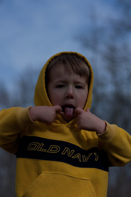

So here is my SOOC image:
Here's what I did...
I was shooting at f/4 1/1000 for a shutter speed. I had my CPL on my lens because I wanted to keep the sky blue. I had metered off the sky. I had my camera pointed to the sky and adjusted the shutter speed until the camera's light meter said it was properly exposed... SOOO, then I used flash for fill. I used my vivitar 285 and I had it at it's highest power and BARE!!! No diffusers or anything... And this is what I got... WTF?!?!?!?!? What am I doing wrong? I know I can fix this in post, but I was really hoping I would be able to get it right in camera... Help??? :(
What shooting mode? Was your camera set up to sync the flash on the shutter opening, or the shutter closing? The 285HV cannot be used in TTL modes.
When doing flash non-TTL, the in-camera meter is useless because it can't meter the strobed light.
Shutter speed controls the background exposure but has to be kept below the cameras x-sync speed. The lens aperture is used to control the strobed light exposure. Motion stopping is done by the flash of light from the strobe.

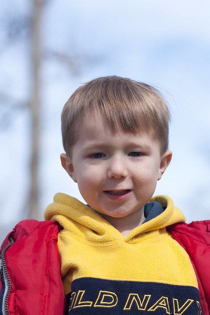

Okay, here's the new one, but it still looks kinda off to me... This is still SOOC... Is this better and more "acceptable"? Or is it still underexposed or is it over exposed at this point?
And I discovered that my flash did affect the sky... So how in the **** do people figure out how to use a manual flash? If you can't use a light meter, how do you know when it's right? Like if I went from f/4 to f/4.5 with this, it got too dark on his face...
There is still CA in this too... There's some green around the top of his head and his ears... I don't think I'm happy with the amount of CA I've been getting from this lens... I can shoot a kid against a sky with my 50mm and get NO CA at all... I guess I just don't get it and that's my problem and this is where I get frustrated and just put everything down for a while...

This looks better, but I think the sky could be a little darker. Trust me, your flash is not exposing the sky... Most likely, a cloud moved in the time between metering and taking the picture.

He has racoon eyes (dark eye sockets).
Either you had your light way to high (judging from the shadows), or the flash is not syncing with your camera and the shadows are from the Sun. I don't really see any evidence of strobed lighting being used in that photo..
There is no way your 285HV can affect the sky (inverse square law).
Use 1/200 shutter speed. Set your aperture to f/8 or f/11. A bare 285 at full power should over expose your kid at those settings if the 285 is somewhat close to him.
Do you have the 285's zoom set to Wide - Normal - or Telephoto?
