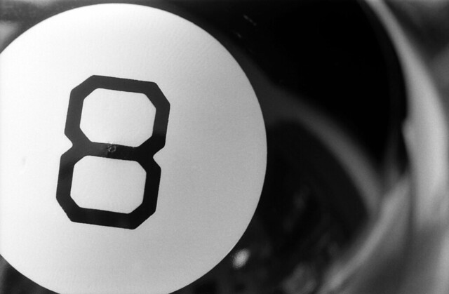

Here's one I shot, developed, and scanned today:
03071103 by J E, on Flickr

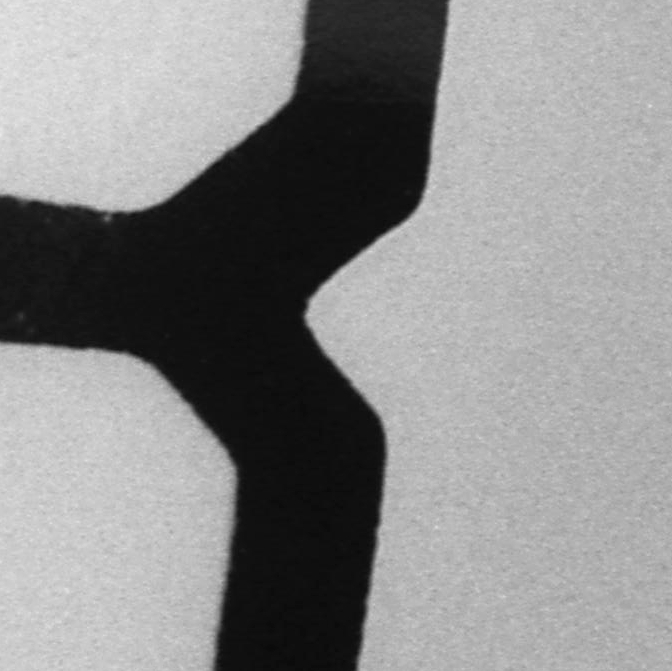

And here's a 100% crop from it:
03071103 - 100percent crop by J E, on Flickr
(3200 dpi scan. Scanned on an Epson V600 using iScan for Linux.)
It was curled a little when I scanned it too (I would say about a 60 or 70 inch radius - what I would consider a mild curl). It doesn't look too bad to me, do you think that's from the tray not being the right height?

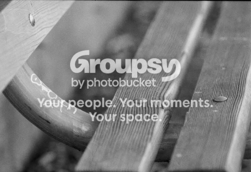

Looking at your examples, the focus doesn't look bad, but it could be better. Although if the film is badly curled it makes it next to impossible to get perfect.

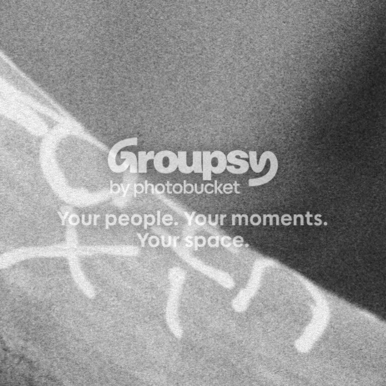

The grain should be distinct and not splochy. Here's an example of close to perfect focus (zero sharpening applied in post, "low" sharpening applied during the scan--most of my film scans don't nail it as dead on as this one):
Here's your example for comparison; notice how the grain in your image is more splochy looking, this means the focus isn't perfect--it's close enough to keep most of the detail, but not ideal.
