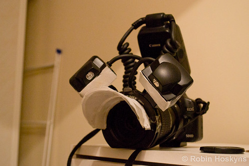

The images are really good. Can't give the lens all the credit - the lighting is very good. Can you share your shooting setup? With the very thin DOF, I'm pretty sure you were shooting on a tripod with a rail system - am I guessing right?
Thanks, nope I was shooting handheld, if you have done much +1x macro then the lens isn't much more difficult to use than anything else. It just takes practice, a steady hand and a few techniques such as the left hand brace and holding breath. I think this lens would be a nightmare to use on a tripod even with macro rails as even handheld it is sometimes very difficult to locate your subject. Here's my setup: Mp-e/mt-24ex diffusion setup by [[BIOSPHERE]], on Flickr

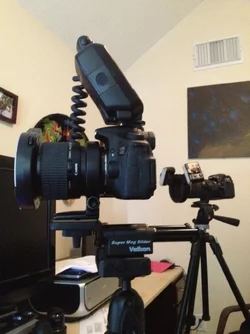

It's not that hard. I use mine on rails attached to a tripod. Next time I'm home I'm going to purchase a new ball head because this 11# ball head isn't cutting with the rails attached.
