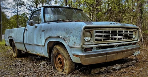

Ok I sure hope you're right as I've been fighting with the color difference problem for a couple of weeks. I know I've made some changes recently to the software so here goes another try. This time as a RGB 8 bit.
Don't let your frustration stop you, study and practice and it will come. I'd hate to see you discouraged by the comments on here (btw I agree with the comments, ironically).
No please don't misunderstand, I'm not frustrated with the comments because I also agree with what they are saying, and welcome the constructive criticism and assistance I've received here. My frustration was coming from "knowing" what I wanted in my mind, seeing one thing on my monitor, and then seeing something entirely different show up online. While the earlier comment about color works space, won't cure all my problems it will sure help. The colors are now the same on multiple devices. This site is great thank you for all the great advice.
What's really going to drive you bonkers next is that your monitors are not calibrated. :-)
And don't even get me STARTED on cheap LCD panels and their color atrocities.
At some point you're going to want to invest in a calibration device at the very least. (They can be had fairly inexpensively)
BTW, what you have looks quite a bit better.
Also... I realize I told you the wrong way to change the color space in photoshop. You have to click Edit->Convert to Profile. Looks like you figured it out, though.
The image is MUCH easier to look at now, however the composition is still weak. This is where I struggle. I can take a very technically sound picture but presenting a thought provoking subject that will make people want to view for several minutes is difficult for me.
In my opinion, this should be the FIRST thought when looking at a scene! Before exposure settings. Before HDR. It seems that to many people want to wow the Facebook crowd with crazy, wild colors without any attempt to create a great photograph. I'm not saying that's you! I believe you are on the right track. Just sharing some ramblings.................

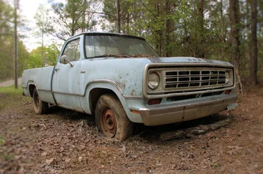

Before I get slammed on the composition, my examples are being posted to glean comments on the technical aspects of HDR. Thanks to previous poster, I'm now showing images online correctly. Two shots, one original somewhat bland, second a (3) image combined HDR at +-2 over/under.

FWIW, I think the compositions of the photos were fine. *shrug*
