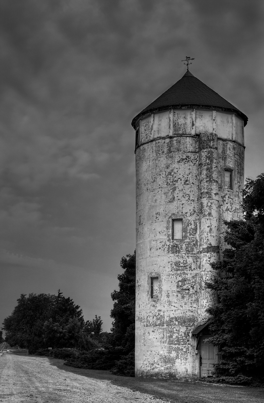

First HDRs - I am disappointed - please C&C
well, looking back at the #2 - I have to agree - not the best HDR candidate, may be it will be a better B&W conversion candidate?
I know, it has halo around the roof and other blemishes, it was literally 30 seconds hack in lightroom, will need to do a proper conversion and gradient exposure filter later :)
actually, no , I was not trying to get them to look unnatural like some HDRs - I just expected more details in skies, and in shadows, but didn't get that - obviously, I missed something important. the tower does look oversaturated to me now as well, I need to try to fix it.
and I did use the lowest ISO - 100, f/11 and was at 35mm - mid range for my 18-50, so it should be as good as my lens can do
What you missed is that additional detail was not there when you shot them, you can't make a storm cloud out of cotton balls. Additionally...The sky does not stop moving...or well we are moving unter the sky constantly, So by default you are loosing detail in the sky because it moved ever so slightly from one shot to the next during all three shots.
Here in lies your dissapointment, the secons shot is not an HDR scene thus not requiring HDR processing, you had in your mind that there was more range to the shot and there was not.
The first shot however, might have been a suitable subject but I feel this scene needed five shots and not three. I think the three shots simply did not get everything that was there, I could be wrong though.
Can I get the three original shots for the first one and go about running it through some HDR processing of my own?
Thats cool dude, but only problem with picture now is that the sky is darker then your object, unreal.
A hint for hdr. In most cases hdri really shines in low light or overcast days.
Don't be too disappointed. I like both of your photos. Much more impressive attempts at HDR than I have done so far. I'm just scratching my head figuring out what I do wrong every time. Maybe I should keep my day job.
