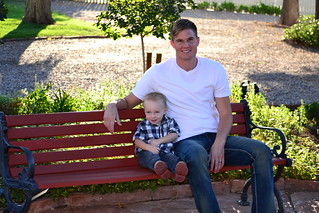

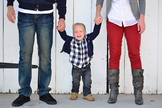

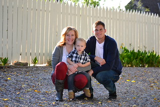

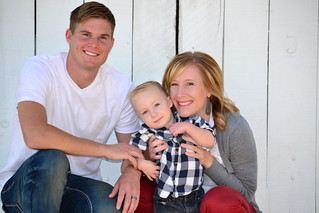

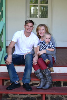

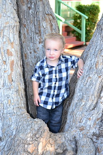

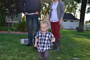

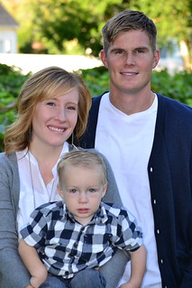

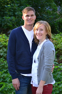

Alright, so as promised, here are some of the better pre-edited/un-cropped shots pictures from the shoot this morning. All these shots were done in aperature mode, with an aperature of 4-5.6. I went back and forth between the 18-55 and 55-200, but mostly stayed around a focal length of 55. I made sure to use the fill flash in most all the pictures. I only have the Nikon photo-editing software at this point, but if you guys have any advice on how these should be edited I would appreciate it. All comments welcome.
1. The shadows from the flash bug me in this picture, but I'm not sure how to avoid that.
DSC_0666 by buangka77, on Flickr
2. I'm thinking maybe the sun should have been more from behind instead of the side as there are some harsh shadows on his face. I guess the built-in flash wasn't powerful enough.
DSC_0651 by buangka77, on Flickr
DSC_0639 by buangka77, on Flickr
4. This picture looks underexposed, even with the flash.
DSC_0616 by buangka77, on Flickr
5.
DSC_0592 by buangka77, on Flickr
6.
DSC_0558 by buangka77, on Flickr

I think I was a little underexposed for most of these pictures and am just wondering what options I have to increase exposure. Obviously there is ISO. I didn't want to increase shutter speed since I was hand-holding and the kid wasn't sitting very still and didn't want to risk having too shallow a DoF with going with a lower F/stop. I suppose I could have used exp. comp. but didnt think of that at the time. Anything else?
Anyway, just looking for any advice on how to do better next time. Thanks again.
If you don't want to change either the aperture or the shutter speed the only options you have are increasing the ISO or extra lighting.
Don't worry too much though, the shots might be a bit underexposed here and there but it's nothing you can't fix with a bit of post processing.
Cute family pics. I really like the last one, it's a nice crop. Unfortunately all the other photos are underexposed and it is very challenging to fix in post. I know because I used to be a chronic underexposer;) (I know that's not a real word)
Once you spend some time learning exposure and lighting you'll be golden!
Thanks for the comments. After coming home and looking at the pictures on the computer, I no realize that I probably should have increased ISO a little. I kept it at 100 and didn't even attempt to increase it, fearing noise. It was fairly light out, but neglected the fact that camera's aren't as sensitive to light as our eyes. Oh well, I'll know better next time. Thanks again.
