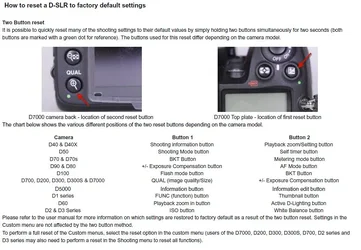

You can try this:
http://support.nikonusa.com/app/answers/detail/a_id/17395/~/how-to-reset-a-d-slr-to-factory-default-settings
I also have a doc that is no longer available...
This will get rid of your custom settings:
The procedure was:
1. Hold down the two green buttons for 3 seconds.
2. Go into the Custom Settings menu (Pencil Icon) and click
Reset Custom Settings.
3. Turn the camera off
Remove the battery
Turn camera switch ON
Hold down the shutter button for 20 seconds
Turn Camera Switch OFF
Replace the battery
Turn Camera ON

You can try this:
The procedure was:
Remove the battery
Replace the battery
Turn Camera ON
