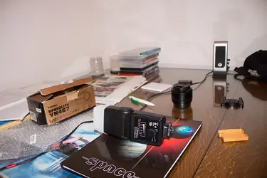

$external  flash (1 of 1).webp$internal flash (1 of 1).webpHere is two examples of pictures, first one with external and second one with internal flash.
Please, i really need help with this.
Data shows that flash was fired and show flash compensation +2.
I tried of camera flash and it works with out flash compensation. i attached example.$IMG_3963.webp
What can it be so it does not work on camera?
