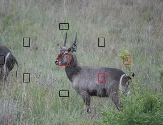

Hi, if you have a canon you can use the Imagebrowser ex to show where you focused while taking the shot.
Here you can see where the camera focused, but the shot is still not sharp due to my errors :angry:
