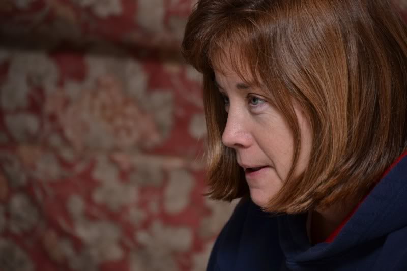

Here's my go at it. I used curves to bring some contrast. Brightened the eyes a bit. Softened the harsh lines under the eye and down along the face. A little sharpening and removed some overall redness. Before and after...
In portraits, it's better to be softer and thus smooth out the skin imperfections.
Too sharp and you bring out all the imperfections of their features.
Increasing contrast makes the skin look very rugged and the face looks older. Yes, you bring out the shadow contrast, but also bring out the skin imperfections. Not good.
