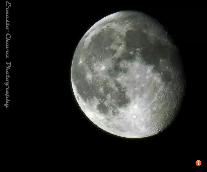

Your focus is a little fuzzy. Did you use a release cable and turn on the mirror lock up? Your lens is going to make it near impossible to get a good enough shot. Your going to need a 300mm or more to make a good image. I took this one with a 200mm and I had to crop extensively.
I would also recommend f16-18 for such an exposure.
Agreed on the lens. I had to crop like crazy on a 70-210. The T3i should have the resolution to crop a fair degree.

The Mirror-Up function eliminates the vibration that you get from the mirror slapping up and down. Not all cameras have that function.
For the purpose of shooting the moon: you want to use the aperture that is sharpest for your lens. Usually this is around f8 or f11. There penalty for using smaller apertures is that you need to use a slower shutter speed or a higher ISO. For a bright full moon, it is like taking a daylight shot. Usually I use f9 at about 1/200 second ISO 200. The higher shutter speed allows a decent shot hand-held, though a tripod will definitely give you better results. Choose an ISO and aperture and then fuss with your shutter speed until you get the results that you want.
The full moon is getting direct light and is somewhat featureless. Waxing or waning moons are more interesting as the tangential light brings out shadows and allows you to see the craters.
