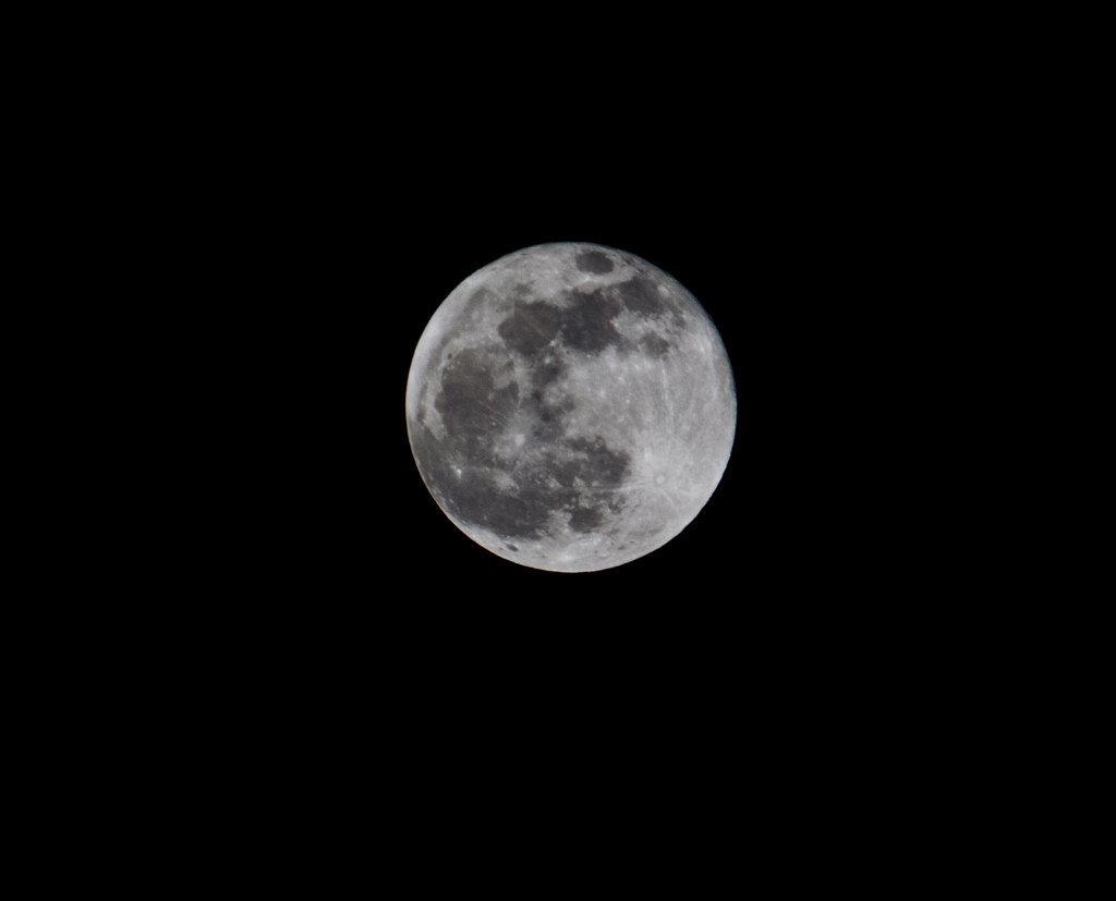

5.6
1/1250
ISO 3200
300mm VR cropped
Handheld
You see, the moon is much closer to the earth in Pennsylvania, hence a hand held shot like yours is not as difficult as in other parts of the world...
Nice handheld shot, I am impressed. Since I stopped drinking, my hands are not as steady.
Of course, I was only kidding about the distance of the moon :D
I am curious, pointing up how did you support the camera in your hands keeping it so steady?

I shot mine hand-held, and played with a few attempts before I got what I wanted. I played with Curves to enhance contrast a little, but I have EXIF data so you can see what I did.
# Aperture: f/11.0
# Focal Length: 500 mm
# ISO Speed: 200
# Exposure: 0.002 sec (1/500)

Edit: Add a moon photo.
This one seems a little over sharpen. but ... here you go.
