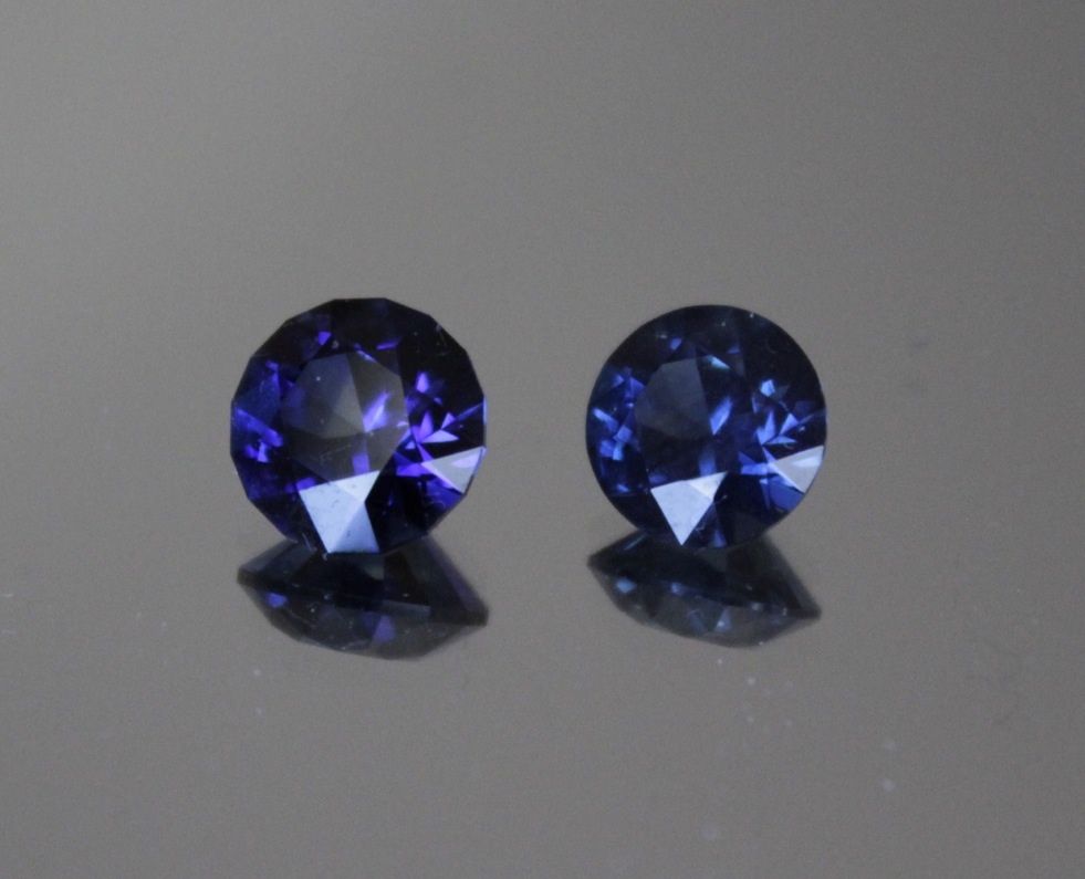

I'm nota photographer in any sense , but now need to be . I facet gemstones and need to get pics to sell them. I would love some info on what to buy , macro and camera , tripod and bits and pieces. Of course I would like to do cheap as possible , lets say under 2k , but could stretch it a bit. I'm just a bit lost to find what will do a good job . Here are a couple of photo that my friend has tried to help me with , not sure what camera , think it had a macro , but might have just been a setting . Any help would be nice :) I also saw someone using image stacking , is that the way?

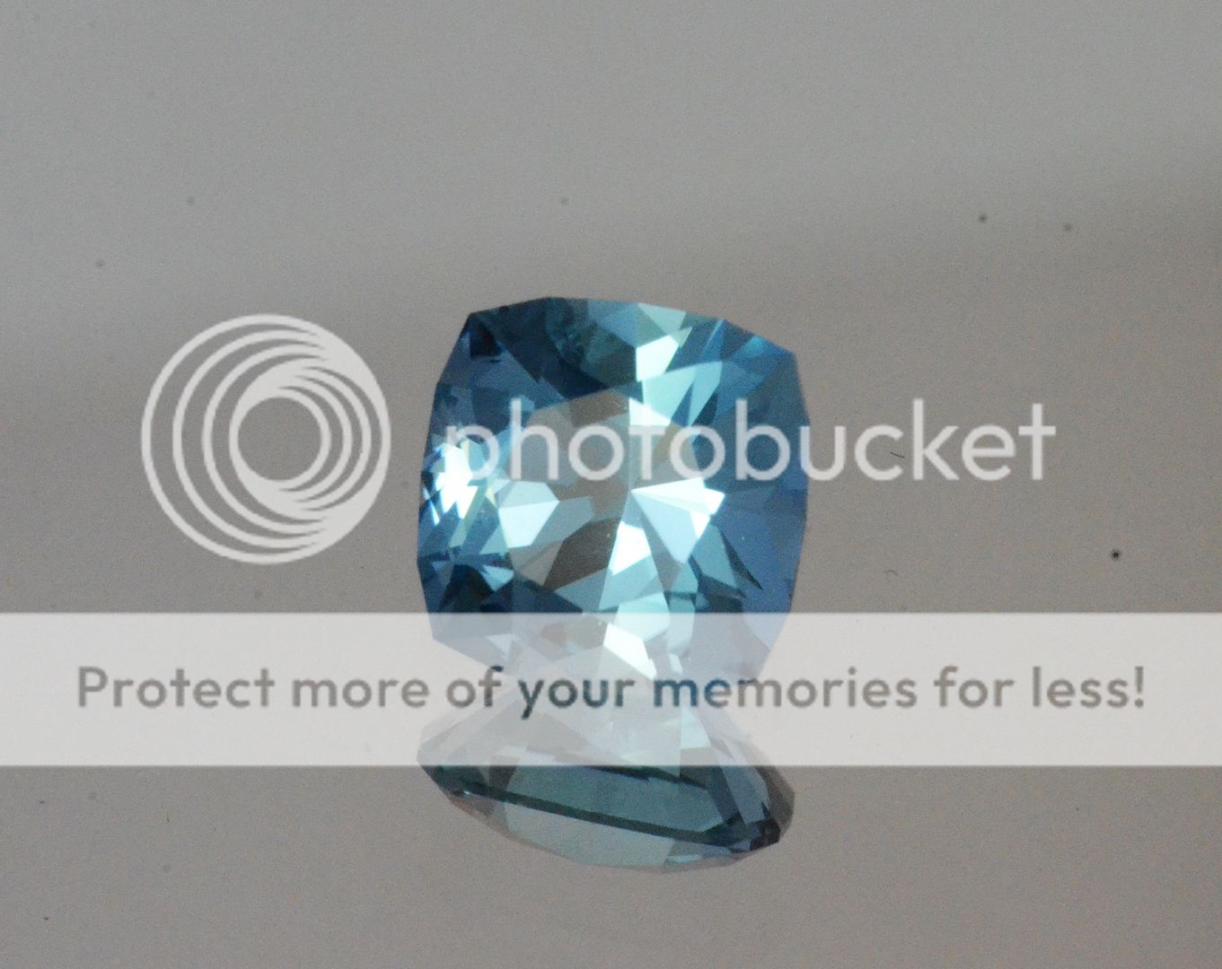

(edit) Now I see your photographs. For me, the biggest problem area is the choice of background. It's not a good color.

edit - PS - on your second photo your friend has "dust bunnies". Those dark dots are dust on the sensor, which shows up when using small apertures (big f numbers). They are easily removed with the "spot heal tool" in photoshop and lightroom (note you can get both those software packages from Adobe for a very low monthly subscription cost now - worth looking into).
Sensor cleaning can be done in nearly any good photography shop or you can do it yourself (lots of guides out there). Sensor dust is part of digital photography and you won't avoid it totally - however in general its easily removed and if you get it you can clean it off so its something to be aware of but not worry about.
Note a clean white sheet of paper with a small aperture (big f number) is the best way to show up sensor dust; complex scenes will hide it and wide apertures (small f numbers) won't show it.
