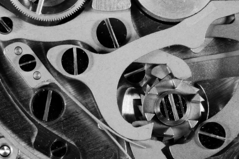

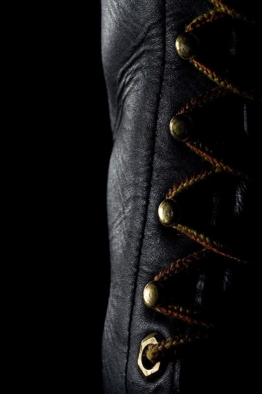

I'm leaning toward the Canon EF 100mm f/2.8 Macro USM
That's what I would (did) get.
Sample pictures
Just realized you want "outdoors, no flash". Neither of these fits that, but the lens is more than capable.
