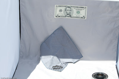

I use them on big shoots most of the time. I have one that "folds" into a carrying bag.
