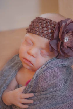

Here's 2 more
I think before you do anything else you probably need to get your monitor calibrated so that you can see the correct colors.
She really did not need any skin smoothing at all. I did remove noise because this was about one full stop underexposed and there was a good amount of luminant noise.

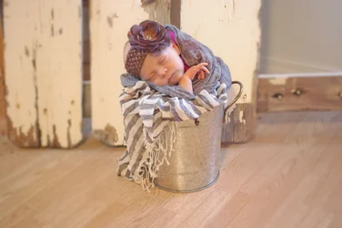

The first upload is ONLY done using Adobe Camera Raw in Photoshop CS6. I'll post my adjustments in a minute.

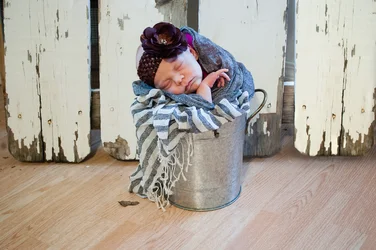

The second is after I took it in to photoshop, roughly cloned the board, used a second layer to bring down that highlight on the side of her head. The cloning is dirty and I'd actually clean it up if I were going to use the image.

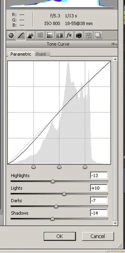

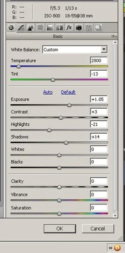

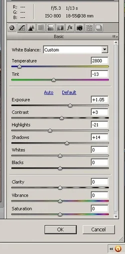

Here are my settings in Adobe Camera Raw. On the curves tab click on the parametric curve I also changed that to a high contrast curve.
