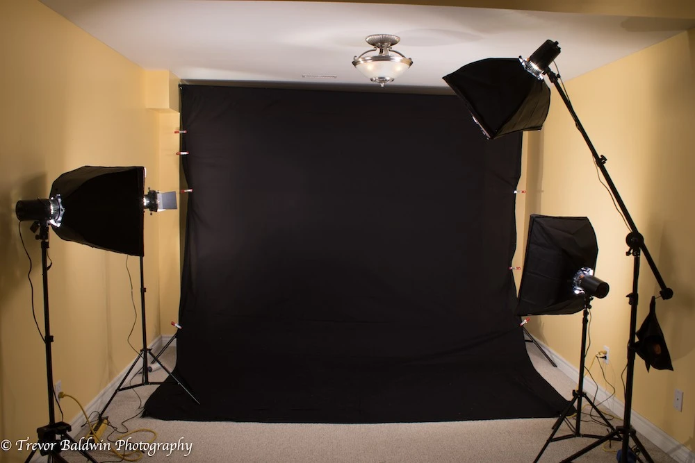

It's not thgat speedlights cannot handle a 10x10 foot shooting area; it is that they have feewer dedicated modifiers to shape the light, and ity is harder to mount larger modifiers than it is with monolights or conventional old-school flash heads. On a mono/flash head, you have mounting lugs for metal reflectors of various beam spreads: small reflectors for "spill-kill"on umbrella shafts, 7" for shooting thru scrims or for using grids; something in the 10 to 11.5 inch for a larger refletive bowl, also for grids and to use with barn doors and diffusing sheets; a 16-inch parabolic, a 20-inch parabolic, and a 20- and or a 22-inch beauty dish.
These reflectors just lock-in to the lugs. Softboxes that use speed rings also just have their speed ring "lock-in" to the lugs. Speedtreon Univeral mount is one: Bowens is another common mount; all mnakers have a prorietary "fit" or "mount". THis makes it very easy to buy accessories that mount easily and quiockly and securely, without the need to make crazy lash-ups to get things connected.
If you want less specularity on the people, less shiny skin, look for a reflecting umbrella, not a shoot-thrugh, one that has a soft, dull white VINYL interior, which gives the most diffused light, or look for something like the Lastolite Umbrella Box, which works VERY nciely with speedlights, and also has a nice light quality. There are a lot of low-cost shoot-throughs where the thin fabric does not diffuse the light very muich, and thgat leads to those hot spots: the hot spot is caused by the hot, centrally-lit "core" of the speedlight hitting mostly the entral part of the shoot-0through fabric; a reflecting unmbrella with a soft, dull-white interior gives a softer, broader light, with less of that central hot-spot.Even smallish, 32-inch refelvting umbrellas are easier to work with than most shoot throughs.

Hey, cool! Monolights!Yes, 200 Watt-seconds is ample. Bowens is a great mount to be affiliated with. Recycle time is definitely faster than what speedlights on batteries can provide, AND monolights can typically shoot for more shots than speedlights, which can overheat under rapid prolonged shooting--which is where studio flash units are typically the best choice, since they have cooling by convection or by blower fan.
Smaller softboxes, like 28 x 28 square with grid can easily be supported on something like an Avenger brand C-stand, with no need for a boom or counterweight.
Try one light from 50 to 72 inches distance, and see what it does. Experiment!
Keep in mind, with a shoot-through, one typically gets 60% of the light going throughk, the other 40% bouncing backward, are refleting off nearby walls or ceilings--which is called "ambient spill". Ambient spill can provide fill light, OR it can make things look very, very flat and dull. In small rooms, it's important to use reflectors that keep the side-ways spill from hitting ceilings or the subjects, so use the spill-kill small reflectors on the monos when using shoot-throughs.
