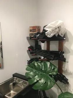

Thanks for the reply. Today I built some racks to store my tripods, stands, and folded modifiers against a wall instead of in a pile in the corner, and in the next few days I'll be installing a pair of big heavy duty wall-mounted boom arms that I found on Amazon. They appear to be pretty amazing from the reviews and customer photos. They can support like 15 lbs, extend 5 feet (my studio is 10x10), fold up against a wall when not in use, and swivel almost 180 degrees both vertically and horizontally. I figure if I can get stuff off of the floor and (functionally) against the walls it won't be a headache to have one stand out with a reflector or light. I'm going to see if there is an appropriate thread to which I can contribute with photos of my stand rack.
Ah whatever, I'll just side track this thread to show the racks. I'm really happy with them. Saved a lot of floor space. They match my coffee table perfectly (mahogany and walnut)
Here they are after putting them up.
