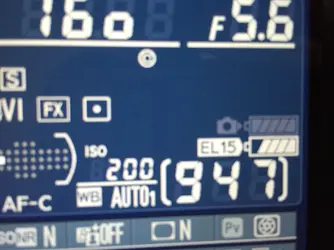

Yeah, that was the plan! I am questioning whether the battery indicator on the top LCD display will portray the grip battery, the internal camera battery (this is what I would guess), or both. Any ideas?

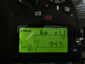

I would guess the top LCD panels indicates what is selected as First in your setup.
My grip battery isn't 100% (the body battery is 100% ) and the top LCD shows a battery not 100%
Oh, awesome! Thanks for the info.
