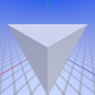

Perspective distortion (photography) - Wikipedia, the free encyclopedia
My wording may be off, but you get my point. This is what I am talking about.
Perspective distortion (photography) - Wikipedia, the free encyclopedia...
And it is either completely off topic in this thread or, if you think it is on topic you misunderstand the optics and physics involved.
The focal length references used in the Wikipedia article apply to only one format. If you use a different format, the perspectives in each image would be associated with different focal lengths since it would require a different FL lens to achieve the same field of view at the same distance. Again, it is NOT the lens focal length that produces the perspective. The perspective difference in the 3 images stolen from Wikipedia is the result of the change in camera position and not the change in lens. The lens change was only done so that the size of the foreground object remained roughly the same in each picture.

Well, you are not understanding me for sure. Now, when you use a crop sensor, it crops. It doesn't do anything else. IT CROPS. It does not change perspective. That is what I am trying to say. To use someone else's words,
What it also means is that the perspective doesn’t change with the crop factor, if you stand on the same spot and take a photograph with a full frame camera with a 50mm lens and then take another photograph with a 1.6x crop factor camera you will get the exact same perspective (the 1.6x camera will however not have the same view of field).
I know that the perspective changed because the camera was moved.....
