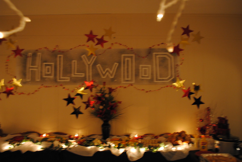

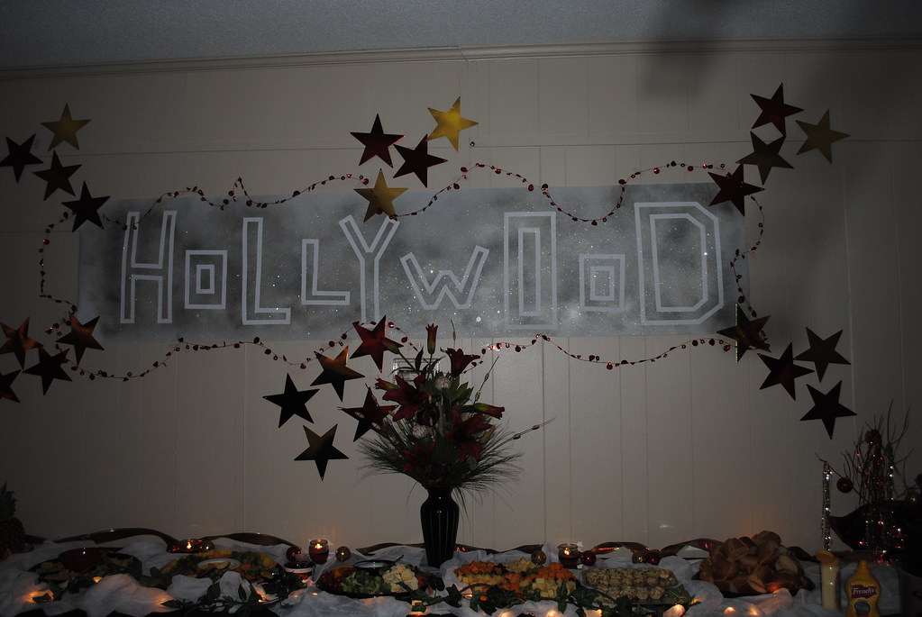

The other night, I took some pictures for a school dance with my Nikon D3000. It's really the first time I've had to use the camera for more than a point and shoot and I pretty much failed. I set it to auto because I was trying to take quick shots of the kids dancing and didn't have a tripod to hold it still. So, with that I had the flash on the camera going off all night. This managed to upset one of the other teachers I believe. Since this is the first time I've been in real low-light, it showed me that I don't know how to use my camera and I was hoping some of you could give me some help on what I should have done right. Here are a couple pictures, one with flash, the other without and it will help to show my lack of ability.
I know I didn't have a steady hand the other night at all and it shows. All help is appreciated!
In low-light conditions and trying to shoot action type shots, you will need a fast lens. With out looking at the EXIF info, it looks like the shutter speed was too low for the conditions.
For something like that, you need to increase the ISO (to probably the highest it'll go), increase the aperature to the highest (lower the number, the wider the aperature). This will then allow you to increase the shutter speed. This probably won't resolve all the issues and you will still probably need to make use of a flash.
Using auto with low light is not a good mix, the only way to shoot in low light is on manual, it takes lots of practise and fast lenses and high iso's like iso3200
