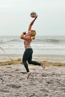

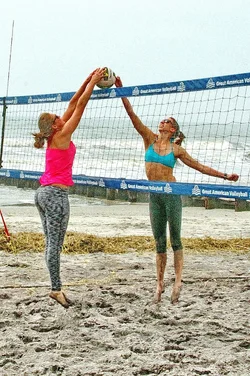

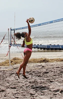

Hello - thanks in advance for any help - I need it! I mostly take beach volleyball pictures with my Canon 60D and Canon Zoom Lens EF-S 18 - 135 1:3.5 - 5.6. I have rented several lenses - most recently the Tamron 70-200mm f/2.8 SP Di VC USD for Canon and the Canon 70-200 F4L. The Tamron almost broke my back and both of them are really just too close up for my personal taste. I'm sure both of those things are probably rookie issues, but I really like 18 - 135 range better.
So is there a lens that would be good for sports that is smaller/lighter but fast? If not, maybe someone could recommend settings that would help? I usually just use sport mode as my attempts with setting on my own were not so hot. I do get some decent pictures but never the cool blurry background ones : ) Not sure if that's even possible with what I have but any ideas that would possibly help would be greatly appreciated.
I'm attaching a couple from a few weeks back using my normal set up - it was overcast most of the day.

Thanks again!

The shots you shared are good compositions and the timing is also very good. I might crop a bit since the outfits, the ball and the net set the scene - no need for the beach.
hence why the 70-200 or longer is the preferred lens here...

The OP needs to in the least use aperture priority mode. The three shots attached were shot at f/8.0, f/7.1, and f/29 respectively in "action mode". Better choices needs to be made here be it from the camera or photographer.
