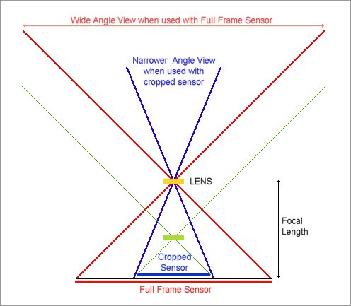

If that is, indeed, the case, then what the hell is this all about? :lol:
(Crop Sensor (APS-C) Cameras and Lens Confusion)
See because the whole first part of that section where that illustration comes from makes perfect sense to me... however what you're saying is that it doesn't matter... which would mean that illustration is wrong.
(I'm seriously just trying to understand all this at this point. :lol: )
All the diagram is showing you is that any lens of the same focal length will give a different angle of view when mounted on different sized sensors. Now this really only comes into play if you want to emulate one format in another or if you have a prior experience of one sensor size and want to understand things in those terms.
However you've only one camera and (far as I know) no serious history with fullframe 35mm film - so in the end you're trying to compare two things, but you've only experience and use of one (the crop sensor).

"Effectively" the diagram is correct if you're trying to calculate the crop factor, but like Big Mike is saying it's the wrong way to look at it and he already explains why.
So it's really not gonna matter if you buy a FF lens vs a crop sensor lens(unless you're going for compatibility with your future bodies). The FOV of 50mm FF lens will look exactly like the FOV of a 50mm crop sensor lens on your camera.

18mms using an EF-S lens (made for a crop sensor) on my crop sensor camera would give me the same field of view as 18mms using an EF lens (made for a full frame sensor) on a full frame camera... correct? (If that's not correct, then I think that's where I'm getting messed up.)
Assuming that *is* correct... then if I took that same 18mm EF lens off of the full frame camera and put it on my crop sensor camera... then I'm going to end up with a field of view equivalent to that of an 28.8mm lens, rather than that of an 18mm lens... Correct? Or not correct?
And assuming that *is* correct, then using that 18mm EF lens is going to give me a less wide (smaller?) field of view than using my 18mm EF-S lens... no? Yes?
This is where my concern is. Because I know what 18mms looks like on my crop sensor while using an EF-S lens. The reason I can't use that lens is because the aperture isn't wide enough for me to use at shows very well. So I want something with a larger aperture, that's going to give me a field of view that I'm used to... so if I want the same field of view that my 18mm EF-S lens gives me, while using an *EF* lens... would I not have to go after an 11mm EF lens to achieve that same 18mm field of view I'm used to?
Nopes here is where the problem lies :)
18mm is 18mm always - however look at the diagram again. The focal lengths are the same, but the larger sensor is seeing more the image circle that the lens is making - whilst the crop sensor sees less. Now this creates the different angle of view even though the focal length of the lens remains the same.
Now if it were an EFS lens attached the only difference is that the lens itself would cast a smaller image circle onto the film. This means that whilst it is still the same focal length its only casting an image circle big enough for the smaller sensor - the outer glass and image circle is not made. This if you were to put it on a fullframe camera body you would have strong shadows and vignetting all around the edge.
