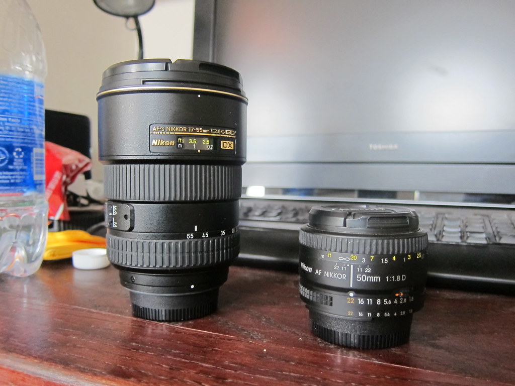

FF lenses are bigger, heavier, and more expensive then DX lenses.
Not exactly.
IMG_1515 by Matt Francosky, on Flickr
On your left, Nikkor 17-55mm 2.8 DX glass- about $1200. On the right, Nikkor 50mm 1.8- about $100. I will let you guess which one weighs more.
p!nK
Sigh..... Your comparing apples and oranges, if they actually made a 50mm prime af in the dx format it would be smaller and lighter.
