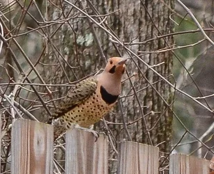

Here's a pic of a Northern Flicker I caught in my backyard. The bird was about 150' away. This is cropped over 75%, shot with a 200mm on the D5100.
Clearly there are some limitations of my lens.
...I'm in the market for a longer reach!

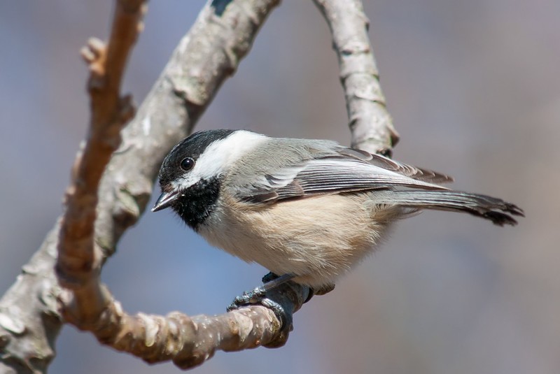

I'm starting to suspect fine tuning at a long distance has far more impact than near MFD. I was shooting my songbirds all winter someplace between 0 and +3. I don't remember exactly. But this morning I was shooting at +8 for my Ospreys. When I got home this Chickadee just had a nice pose in the sun. So even at +8 up close I think it is still looking good...
Chickadee by krisinct, on Flickr

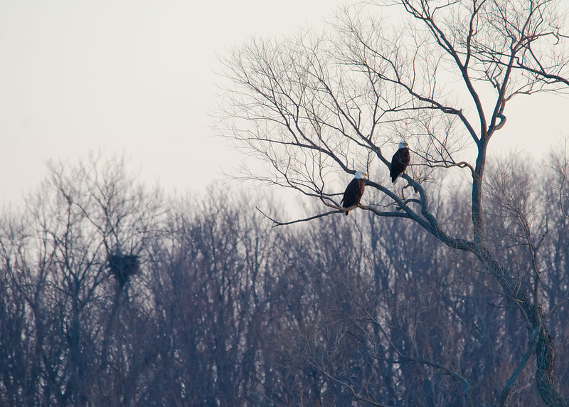

This is my eagle shot that I was talking about where is was 126m or 413feet away. I'm fairly happy with the results.
Eagles with their nest in the background by Shefjr, on Flickr

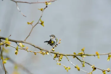

$RAW_0814.webpView attachment 41972
for web this works fine, of course not print worthy. of and that's 700mm with a bird not very far away, warblers are small man
