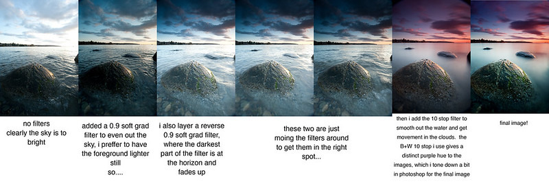

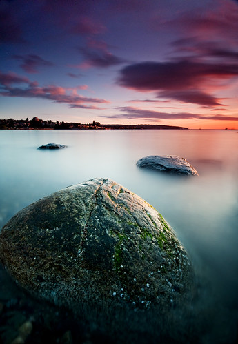

someone asked me a few weeks ago to put together a before and after of how i shoot my long exposures with my filters. so i thought it would be fun to post it here incase anyone is interested.
and as always i would love some c&c i really like how the green in the rock came out in the foreground, but i'm not sure if the overall composition is pleasing?
its a rock by abbye dahl, on Flickr
how to filters by abbye dahl, on Flickr
Your shots are an inspiration, as is your vision, Abbye. Thank you for sharing your technique. Something to emulate and to learn.
Very nice guide Abby. Thank's. Picture beautiful to !
a lot of work, time and investment, it shows.

hi charlie,
the filters are not a software thing, they are physical resin and glass filters. i use lee filter set, as well as a B+W 10 stop filter, and one sighn-ray filter

Awesome post! So nice to see some real,old-fashioned lenswork is being done! Would LOVE to see additional posts you might contribute on say, use of 2- and 4-stop soft-edge and/or hard-edge grads, or whatever you come up with.:thumbup:
hahahah well derrel, i would love to, if you would buy me some more filters.....
Two thumbs up. You nailed it. A good example of filters being used the right way.

By the way, does using the combination of soft edge+reverse grad produce the same result as using one hard edge filter? I already have soft-edge GNDs and currently deciding if I should go for the reverse grad or the hard-edge GND. Thanks! :wink:
not quite, a hard edge filter still is very dark at the top. in the case of sunsets, where the brightest part of the sky is the horizon, i find layering filters often causes the top of my sky to under expose to a nasty black vignette. the reverse filter gets quite light at the top, which allows the sky to stay properly exposed while still capturing the colours and lights on the horizon.
not really that useful unless your shooting sunsets however.
